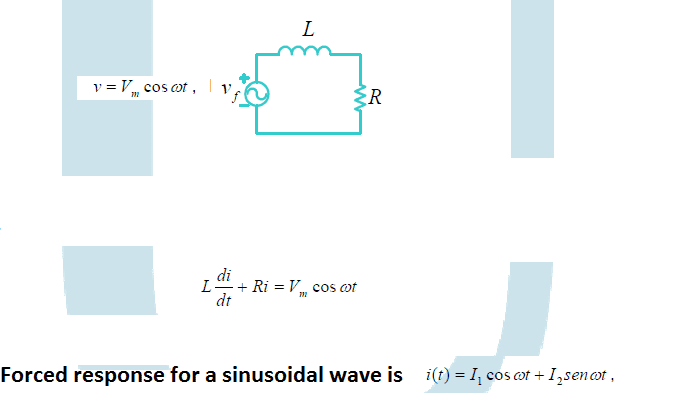

Hi people.
I started my AC circuits course in college, but this stuff is either too tough or I probably don't have some math prerequisites.
By the way, I'm just starting my differential equations course, but I haven't had any time to study just because AC circuits won't let me make any progress.
So this is what happens, the first topic is all about the forced response of a circuit, but I can't make any sense of it
Take a look at my first attachement "dontget.png"
According yo my course's module or textbook, it says that the RL circuit's response I1coswt + I2sinwt . Just how do they know that?.

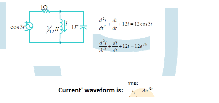

And please take a look at the second attachement.
I can understand where 12i and d2/dt2 came from, but I cannot understand where did di/dt came from.
Besides, according to the textbook, the current's waveform "Obviously shoud be Ae^j3t." How is that even possible?, how do they anticipate the circuit's response?.

Looking at your circuit further...shaking out the cobwebs...
The d2/dt2 is tricky to get. You obviously know the Cdv/dt=i(t) and that Ldi/dt=v(t).
When you do a loop analysis like KVL and you are looking for the current for example...your loop equation looks like this
Cdv/dt (current through capacitor) +...here's where it get tricky...you can't right the current through the inductor (unless integral) but you just write something like Cdv/dt again (because you know this equals the current)...except now you have to plug the v(t)=Ldi/dt into the Cdv/dt...taking the derivative of Ldi/dt...getting L*C*di2/dt2.
Something like that...look in your book...should give example. Sorry not exact...but best I can come up with at the moment.
Problems of this kind assume: stationary state (all transients have decayed) and linearity of all elements. So if you put in a frequency, you get the same frequency out. The current may have a phase difference, but the frequency will always be the same, and the current will be sinusoidal. A complex A (Amplitude) or I1sin + I2cos are simply different ways of writing a phase-shifted sinusoidal current.
In RLC circuits you often get an integral term (because voltage is prop. to charge = [itex]\int[/itex]i).
By differentiating your equation you get a 2nd order differential equation. (This step isn´t documented in your attachment, but something like this might be missing)
Don´t give up!

The way of thinking that calms me down goes like this.
Inductors and Capacitors are some weird devices, which follows these (listed below) rules by virtue of their construction and nature of electrons/magnetic fields/electric fields/physics laws/etc
Rule(1) : Inductors: Voltage across it (E) = L * rate of change of current through it (di/dt)
Rule(2): Capacitors: Current through it (I) = C * rate of change of voltage across it (dv/dt)
So, when these elements are put together in circuit, in various configuration and we put some source, we just define a bigger rule, like
Rule(3): L*di/dt + V_capacitor + I*R = V_source*Sin(wt)
i.e. what we are saying is,
If inductor is to follow rule(1), capacitor is to follow rule(2), then our ckt, by logical reasoning must follow rule(3).
Our task is to use some mathematical tools (methods) to re-define rule 3 in simpler terms, i.e. find the expression for I = f(t).
(this is the differential equations part)
I often view differential equations as, like
10*di/dt + i = 5*sin(wt)
as:
We know the nature of I, its 10 times rate of change + its current value must follow sinusoidal nature with amplitude 5. You are given its initial values too.
Now, find an expression for I?
Its purely a logical question, but we seldom use logic, but instead use some rote-learned techniques to find the ans.

It's good you want to learn this...but I think the question you are asking is a fairly small part of AC. It's not really this bad. Eventually it's more about adding vectors in non resistive circuits and so forth. So don't get too dragged down...you'll be on to easier more interesing stuff soon.
The vectors come in with the "J" in the Jwl and 1/Jwc. Reactances of inductors and capacitors. You will use the same rules to add reactances in series and parallel just like you did in AC...but now you obviously have vectors that are no longer at 0 degrees...so you need a little more math.
No biggy...in the end...V=IR
