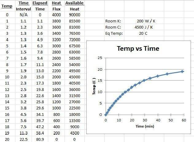

So let's assume that this room of ours reaches 19C in one hour. Here's what that looks like:
Likes baracoda

I have some questions:
1. By 0C weather you mean temperature outside?
2. What is the differenece between temperature and room heat?
3. What doest it mean that available heat is -20?
4. If I understand correctly the input data is in columns Temp, Room Heat and Heat Flux. The rest you calculated using some formulas. Is it possible that you would send me the excel file with this example as I have a problem with figuring out where did the values came from.
5. I am also not sure what is Room K and Room C.
Thank you.
Yes.

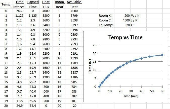

So, first a little mea culpa. "Room Heat" and "Available Heat" were somewhat redundant, or, rather, "Room Heat" was actually meaningless. I'll explain in more detail below, but here's a corrected spreadsheet, showing only "available heat" (notice the result is pretty much the same -- the "Room Heat" column wasn't really doing anything useful).
Newton's law of cooling is like emptying a bucket of water, except that instead of water, you have a container full of heat (thermal energy). "Available Heat" is the amount of heat that has to be added to the room in order to bring the temperature up to the desired 20C. "Room Heat" was intended to be the increment of change when it gets 1C warmer, but it was unnecessary and I didn't do it right anyway, so you can ignore that (and I've removed it). Temperature is just the temperature of the room at each time.
However:
This is somewhat moot now, however please note that an iterative method like this is not exact. It has errors. Namely, it assumes a constant heat flux for an each 1C step, which isn't true - the reality is that the heat flux changes continuously. With the new version of the spreadsheet, the error is hidden, but note that in the true version of Newton's Law of Cooling you don't ever get exactly to your target temperature: the last line of the spreadsheet is always very significantly wrong. In the rest of the steps, the errors are relatively small.

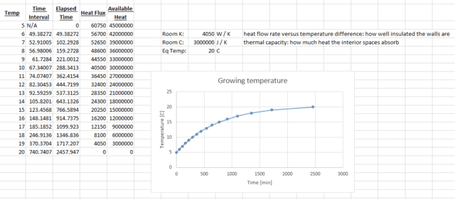

Attached.
They are my versions of constants that go into Newton's Law of cooling. K is the heat flow rate versus temperature difference: how well insulated the walls of the room are. C is the thermal capacity of the room: how much heat the interior spaces absorb. I believe in Newton's actual Law of Cooling they are combined into one constant.
  • Room Heat.xlsx
Likes baracoda
@russ_watters that is great! Thank you once again. I am studying it know and trying to understand and apply it to more real life example. I have found an information that for 30m2 room with 200kg of furnitures thermal capacity is more or less 10^7 J/K so I have to find appropriate room K, because now the results are completely wrong. Now I am trying to get the following:
- I have room temperature
- I have outdoor temperature
- I have max temperature in the room the heater can produce
- I am calculating how much time it will take to get to:
a) current room temperature - 2C
b) current room temperature + 2C
I am having a problem with this due to the following reasons:
Two questions as for know:
1. room K and room C use Kelvins and the temperatures provided are in Celsius. Is it ok?
2. I have a problem finding any information about heat flow rate value as I wanted to find estimated for my 6x6x3 room. How did you came up with the 200 W/K?

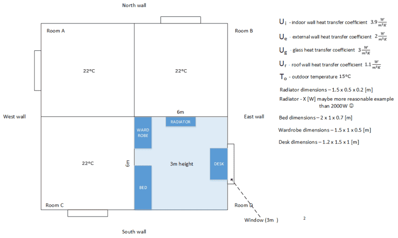

Ok, I found some U-values and calculated that for my room Power (W) = 270 * (temp_inside - temp_outside), so for 20C inside and 5C outside it is 4050W.
How can I go from 4050W to the W/K unit? Or is it already 4050W/J?I have went through Newtons Law of Cooling and I understand the concept now (thank you for the link) but I am not sure where did you get the formulas to calculate available heat, heat flux and time interval from. Are those well known equations?
And how have you came up with thermal capacity of the room equal 4500 J/K?
Is it from the equation: E=m*c*deltla T
where:
m - mass in kg
c - specific heat capacity of the material
delta T - temperature change
I have assumed that the room has two internal walls made from concrete, two outer walls made of brick, one window and roof made of wood. I calculated its mass and found specific heat capacity and I have calculated that my room has heat capacity ~ 3 000 000 J. Is it also J/K?
Putting those calculated by me room K and room C in the excel I get a result that a room from 5 to 20 degrees will have to be heated for 16h. Am I doing sth wrong?
Have you used for something information about my imaginary 2000W heater?

So, there's another issue with my spreadsheet. Somehow in playing around I got away from your scenario a bit. The initial heat flux is determined by the heater and, alternately, the room construction (insulation). The goal of this scenario is to start in one equilibrium, turn on a heater, and get to another equilibrium. I probably initially selected a 10K (or C -- I probably shouldn't have mixed them) temperature difference and then changed my mind and made it 20K. But the way I designed the spreadsheet, the temperature difference drives the heater output. So the starting heat flux is 4000 W with a 20K delta-T. You can change to a 10K delta-T to get 2000W or leave the delta-T and change the room K value to 100 W/K.
The "Heat Flux" is the net heat transfer into the room: the 2000W (or 4000W) of the heater, minus the heat loss to the walls. So if we start off in equilibrium at 0C, the heat loss is zero.

I generated it manually - just plugging in numbers, not by trying to design a room. Newton's law of cooling let's you work backwards from the performace of a room to find the constants instead of trying to calculate the constants from the design of the room (since I didn't know anything about the design of the room).
No, heat capacity in Joules would be the total heat it can hold with a certain temperature difference. But there's a problem with your calculation: the room boundaries are not sharp. The walls are part of the boundary, so only some of the wall gets included in the heat capacity of the room. That's a lot of what makes your method so difficult and best ignored if you're just tyring to do some programming.
Likes baracoda
  • #31
4050W is the power needed to maintain a15C difference between inside and out. If you want that in W/K (or W/C) just divide by 15.
