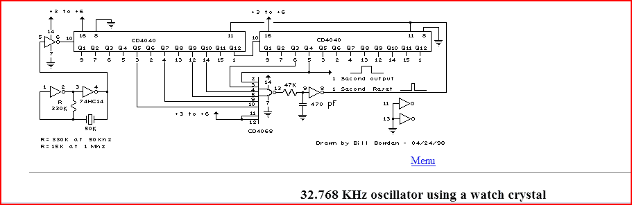

Build an electronic oscillator? Any voltage will do. It drives a led. Target frequency I 1000 hertz.
Step 1) Look up the datasheet for a CD4040 oscillator/divider IC.
Step 2) Use a 9V battery for the power supply (check the datasheet to be sure this is within the allowed power supply voltage for the CD4040
Setp 3) Use this tutorial web page to help you build and test the circuit...
http://www.bowdenshobbycircuits.info/page11.htm

This is for beginners?
Yeah, it's all low-frequency digital stuff. The only simpler thing would be to buy a kit and assemble it...
