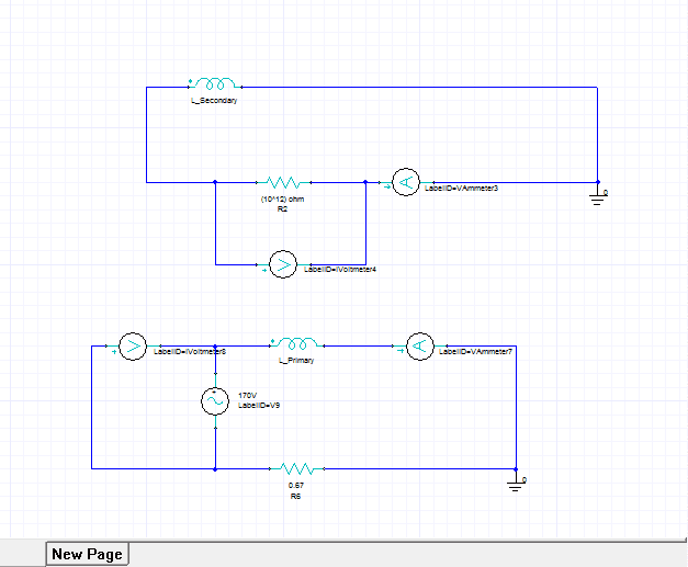

i have find a solution for the last problem, need to have Winding 1 and 2 in the same circuit editor.
but i have another problem (see the drawing) maybe someone know what ?

It looks like the name of Your coil in Circuit Editor is different than this one in Maxwell 3D (they must be the same).
Using resistor as a load of transformer ? Nothing more simple, connect it in series with winding. No "magic" here ;)

Add a minimum resistance (like 1e-6 ohm) in series to circuit with voltage excitation. This small resistance has almost no effect on results but helps Maxwell to start simulation
Regards
ok, it's better I don't have the error about loop current but I have always the first error in the message "don't have enough memory or killed by user".
