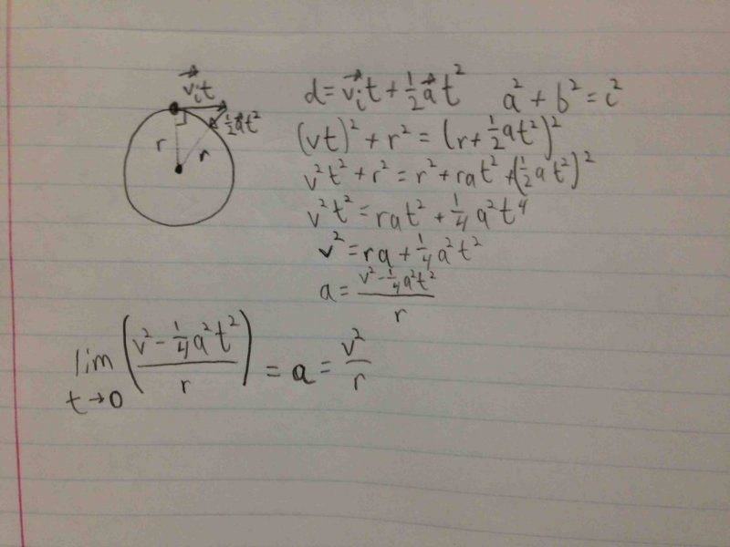

Currently we're discussing uniform circular motion in my physics class.
The previous unit discussed vectors and vector addition in the i, j, k format. When I try to apply the rules for vector addition to find the resultant velocity in uniform circular motion, I get an increase in the magnitude of the velocity vector.
For example, say an object is in uniform circular motion around a circle of radius 2m with a tangential velocity of 6m/s. It's centripetal acceleration, v^2 / r, is therefore 18m/s^2 perpendicular to the direction of motion.
So if the tangential velocity = 6i + 0j, and if the centripetal acceleration = 0i + 18j, the resultant vector would have a magnitude of sqrt(6^2 + 18^2) or about 19, which clearly isn't uniform circular motion.
How should I think about this problem differently? Is it correct to add the initial velocity vector and the acceleration vector to find the final velocity, even though the units are different?

Our book actually discusses non-uniform circular motion too, and resolves the acceleration into a radial and tangential acceleration.
So in uniform circular motion, there is no tangential component to the acceleration, and therefore the speed is not affected.
What I don't understand is how mathematically to go from the tangential velocity vector and the centripetal acceleration vector to the resulting tangential velocity vector at another point along the circle.
Is not the definition of the acceleration vector the final velocity vector minus the initial velocity vector, and therefore is not the final velocity vector the initial velocity vector plus the acceleration vector?

I think the basis of my understanding of velocity and acceleration is false. I thought that the acceleration vector was defined as the final velocity vector minus the initial velocity vector. My textbook has diagrams like this one that label the change in velocity vector as the acceleration vector.

I'd love to be able to derive it myself. Can you point me in the direction about how to start the process? I'm not sure how to approach the problem.
How can I mathematically or pictorially express the fact that some acceleration, when applied to an initial velocity, leads to a final velocity of equal magnitude but changed direction along a circular path?

Ok, I'll give you a hint, but my hint might not help much cause I'm trying to not ruin it :smile:
I would consider a small time Δt, and then work out what the acceleration needs to be to keep the object on the circle, then take the limit as Δt→0
(When I first derived this formula, it took me at least several weeks! And it all started with questions similar to yours.)
(My motivation was my passionful hate for memorizations :-p)
If you can't figure it out, let it sit on the back of your mind for a while.
As a hint for understanding acceleration, consider this equation.
Δv=a Δt
A change in velocity results from acceleration acting over a small time interval. If the acceleration is changing over time then you won't be accurate if the Δt is large.
So circular motion obviously involves the acceleration changing in direction over time. So first you start drawing a bunch of tangent vectors at time t1, then t2, then t3, and so on. You make them closer and closer together, making Δt smaller and smaller. Then you draw the acceleration vector that on average over those smaller and smaller times gives that change in velocity, Δv. The acceleration will rotate.
But in circular motion, the tip of the velocity vector goes through a circle. So too does the tip of the acceleration vector. And with a little effort you can figure out the radius of each of those circles, and so the magnitude of the vectors.

There's also an easy way with just algebra and basic trig (and, at the end, a limit) if you assume acceleration is constant.
Thank you guys very much for helping me head in the right direction on this.
I'll keep looking into this on my own and wrestle with it some more and get back to you!
Was very excited when I figured this out! Was this the direction in which you intended to point me?
