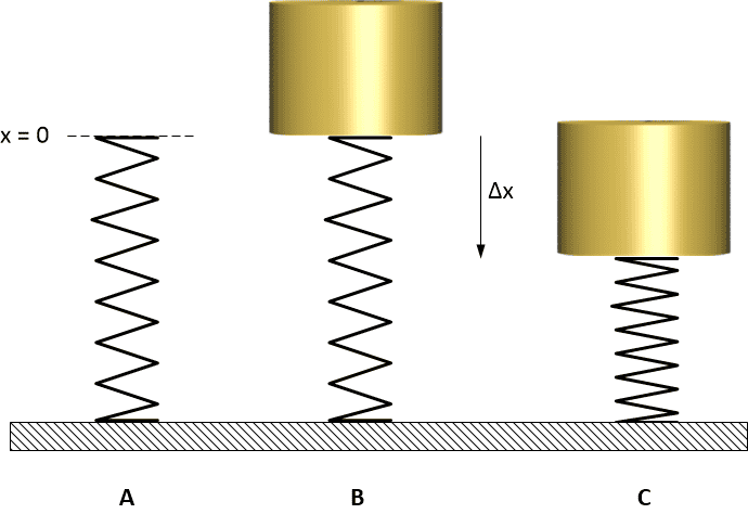

Let me paint a picture in three panels:
In A we have the spring 'at rest'. For later reference I added a reference level ##x=0##.
And additionally I define a positive direction 'up' for x, coincident with the positive direction for ##h##.
In C we have the spring + mass at rest on it.
'at rest' meaning the mass is not moving wrt the floor.
In between I drew B where the mass is on top of the spring, not yet compressing the spring but held in place by some upward force ##F = Mg## (The uppercase M you use)
How to get from B to C (where the upward force ##F = mg## is now entirely due to the spring -- so with your formula you have ##k\Delta x = Mg## ) ?
You have ##\Delta E_G = Mg\Delta x## on the one hand and ##\Delta E_{\text spring} = {1\over 2} k\Delta x^2##
How can these two be matched ? After all ##k\Delta x = Mg\ \Rightarrow \ k\Delta x^2 = Mg \Delta x## but then what about the ##\Delta E## ?

There is an explicit reference to the height, ##h##, of the mass. It seems reasonable to interpret ##h## as the height above some chosen ‘reference level’ (say the floor). And then use GPE = mgh.
Suppose the system is in equilibrium but suddenly the mass becomes detached from the spring.
When the spring and mass finally come to rest on the floor (after bouncing around a bit) the ‘mechanical energy’ has been dissipated – causing heating.
(If this occurred in an isolated system and we knew the overall heat capacity, we could even find the temperature-rise.)
In the final state, GPE = EPE = 0 (using the usual conventions). So the required mechanical energy is simply the sum of the initial GPE and the initial EPE. (This, I think, is a description of what @haruspex referred to as ‘readily available mechanical energy’.). The initial mechanical energy can easily be expressed in terms of ##M, g, h## and ##k## only.

All that is fine but does not address the original question " Calculate the amount of mechanical energy if the mass is at rest." I can understand that a certain amount of Joules can be recovered by all sorts of processes that cross the boundaries of the system.
If these processes conserve mechanical energy, the initial mechanical energy does not change. The "recovered" energy is energy converted into a different form of mechanical energy by conservative forces. We can find that number but how does that help us find the total that is conserved?
I take $8.53 out of my left pocket and put it in my right pocket. I then ask how much money I have in my two pockets together. The reasonable answer is, the total amount is unknown but you have at least $8.53 in your pockets.
If the processes of energy conversion are not conservative, then it becomes worse. My right pocket has a hole and one cannot even guarantee that I have at least $8.53.
