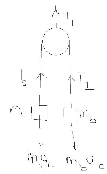

f = ma
t1 tension in string connecting Mc
t1 tension in string connecting Ma and Mb
m_c:\\
m_c g - T_1 = m_c a_c\\
i considered pseudo for acting on masses b and a from a non inertial frame of reference
hence in that frame of reference mass b will go down with aobserved and mass a will go up with a observed
m_a,m_b:\\
a_{observed} = \frac{(m_b - m_a)a_c}{m_b + m_a}\\
a_b = a_c - \frac{(m_b - m_a)a_c}{m_b + m_a}\\
a_a = a_c + \frac{(m_b - m_a)a_c}{m_b + m_a}\\
T_2 = m_a a_a = m_b a_b\\
2 T_2 = T_1\\
is this correct i have feeling something has gone wrong
but how could i solve without pseudo forces i feel very uncomfortable having to switch frames of references

You do not need pseudo force. The "observed acceleration" in the accelerating frame of reference is the relative acceleration with respect to the table (in rest), equal in magnitude and opposite in direction for a and b. The acceleration aa and ab are ac+arelative.
Your work is correct so far, go ahead.
Likes timetraveller123
no but i used the concept of pseudo force to derive the result for observed acceleration
is there a way to do away with it
as observed in accelerated frame of reference
Forget accelerating frame of reference. Even then, if the acceleration of block A is arel with respect to the horizontal pulley, that accelerates with ac , the relative acceleration of block B is -arel and aa=ac+arel and ab=ac-arel. Draw the FBD for each block, write the ΣF=ma equations in the rest frame of reference, eliminate the tensions and solve.
wow i got the same result without having to use pseudo forces had been having a lot of problems when acceleration was involved but this arel concept cleared it up a lot thanks the rest is just solving the equation i have a few general questions :
