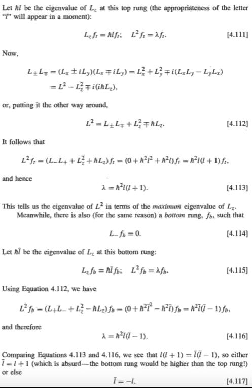

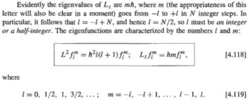

The book uses ladder operators ##L_+## and ##L_-## to find the eigenvalues ##m## of ##L_z##. By first deducing that these operators raise or lower the eigenvalue by ##\hbar##, and then deducing that the lowest eigenvalue is the negative of the highest eigenvalue ##l##, it proves that ##m = -l, -l+1, ... , l-1, l##.
But I suspect these values of ##m## may not be exhaustive, at least not proven to be by this method. This is because the use of these ladder operators is quite arbitrary; there may exist other operators that change the eigenvalue by say ##\frac{1}{2}\hbar## or ##\frac{1}{3}\hbar##.
Am I right to say the method of using ladder operators ##L_+## and ##L_-## could not give us all the possible values of ##m##?

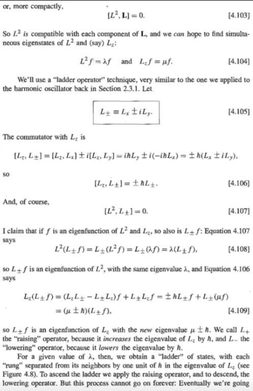

The key point indeed is that you look for irreducible representations of the Lie algebra su(2) (aka angular momentum operators). This implies that you look for a complete set of orthonormalized vectors spanning the corresponding vector space the representation lives on. To that end you need to specify a complete set of commuting operators, and in the case of su(2) these are ##\hat{\vec{J}}^2## and ##\hat{J}_3## (or any other component, but conventionally one uses the 3-component, as we usually choose the 3-axis as the polar axis of spherical coordinates).
Then the proof is complete: For a given eigenvalue of ##\hat{\vec{J}}^2## the possible eigenvalues for ##\hat{J}_z## are bounded. Further since you look for an irrep the operator algebra (spanned by ##\hat{\vec{J}}##) acts transitively on the Hilbert space. Since the ladder operators ##\hat{J}_{\pm} = \hat{J}_1 \pm \mathrm{i} \hat{J}_2## lower and raise the eigenvalues of ##\hat{J}_z## by one unit (in units of ##\hbar## of course), you must have ##\hat{J}_+|J,M_{\text{max}} \rangle=0##, because otherwise ##M_{\text{max}}+1## would be an eigenvalue of ##\hat{J}_z##, but that contradicts the assumption that ##M_{\text{max}}## is the maxmal possible eigenvalue at in the space of eigenvectors of ##\hat{\vec{J}}^2##. This analysis leads to the conclusion that the eigenvalues of ##\hat{\vec{J}}^2## are given by ##j(j+1)\hbar^2## with ##j \in \{0,1/2,1,\ldots \}##. Each of this possible values determines uniquely an irrep of su(2), and for each ##j## the eigenvalues of ##\hat{J}_3## are ##M \in \{-j,-j+1,\ldots,j-1,j\}##.
I think you guys misunderstood my point. I was saying it’s possible ##m=-l, -l+\frac{1}{2}, -l+1, ... , l-1, l-\frac{1}{2}, l##. Just because the ladder operators ##L_+## and ##L_-## find ##m## values that differ from each other by integer amount, it doesn’t preclude, I think, the possibility of the existence of some other operators that could give other ##m## values.
No that's not possible. The ladder operators action on an eigenstate of ##\hat{L}_z## follows uniquely from the commutation relations of the angular-momentum operators. They thus uniquely change the eigen value by ##\pm \hbar## and NOT by ##\pm \hbar/2##!

Remember we are talking about the possible eigenvalues of one operator, ##L_z##. So there would have to be operators other than ##L_{\pm}## that would take an eigenstate of ##L_z## with one eigenvalue, and change it to an eigenstate of ##L_z## with another eigenvalue. Call such an operator ##X##.
Now work through the same logic that Griffiths goes through, applying ##X## to an eigenstate of ##L_z## and writing down the equation ##X## would have to satisfy in order to change that eigenstate to another one whose eigenvalue differed from the first by something other than ##\hbar##. You will see that, as in equation 4.109 in Griffiths, the change in eigenvalue is given by the commutator of ##X## with ##L_z##, i.e., ##[L_z, X]##. So for an operator ##X## to change the eigenvalue of ##L_z## by something other than ##\hbar##, we would have to have ##[L_z, X]## be something other than ##\hbar## (but not zero).
But there can't be any such operator ##X##, because any such operator would have to be expressible as a linear combination of ##L_x##, ##L_y##, and ##L_z##, since those operators span the space of possible operators on spin states, and any linear combination of those operators must either commute with ##L_z## or have commutator ##\hbar## with ##L_z##. (In fact it should be evident that ##L_{\pm}## themselves span the space of possible such operators that do not commute with ##L_z##.)

In the following I work in natural units with ##\hbar=1##.
I don't understand this argument. A ladder operator ##\hat{X}## for ##L_z## eigenstates must have a commutation relation like
$$[\hat{L}_z,\hat{X}]=\lambda \hat{X},$$
because only then
$$\hat{L}_z \hat{X} |m \rangle=([\hat{L}_z,\hat{X}]+\hat{X} \hat{L}_z)|m \rangle=(\lambda +m) \hat{X} |m \rangle,$$
i.e., ##\hat{X} |m \rangle## is eighter 0 or an eigenvector of ##\hat{L}_z## with eigenvalue ##m+\lambda##.
Now we want an irrep of the entire Lie algebra su(2) generated by the ##\hat{L}_k##. Due to Schur's Lemma this must be an eigenspace of ##\hat{\vec{L}}^2## since ##\hat{\vec{L}}^2## is the only Casimir operator of su(2). From the commutator relations
$$[\hat{L}_j,\hat{L}_k]=\mathrm{i} \epsilon_{jkl} \hat{L}_l$$
it's clear that the operator ##\hat{X}## must be a linear combination,
$$\hat{X}=a \hat{L}_1 + b \hat{L}_2.$$
The commutator with ##\hat{L}_z## is
$$[\hat{L}_z,\hat{X}]=\mathrm{i} (a \hat{L}_2-b \hat{L}_1) \stackrel{!}{=} \lambda (a \hat{L}_1 + b \hat{L}_2).$$
This means
$$a=-\mathrm{i} \lambda b, \quad b=\mathrm{i} \lambda a.$$
This homogeneous system of linear equations can only have non-trivial solutions for ##\lambda = \pm 1##, and the corresponding operators are
$$\hat{X}_{\pm}=a (\hat{L}_x \pm \mathrm{i} \hat{L}_y)=a \hat{L}_{\pm}.$$
From only this we can draw the conclusion that ladder operators for ##\hat{L}_3##-eigenstates can change the eigenvalues only in steps of ##\pm 1##. And the ladder operator must be proportional to the usual ladder operators ##\hat{L}_{\pm}##.
Now you have to fulfill also the eigenvalue equation
$$\hat{\vec{L}}^2 |\alpha,m \rangle=\alpha |\alpha,m \rangle,$$
and then you can use the usual argument with ##\hat{X}_{\pm}## as with the ##\hat{L}_{\pm}##. Since you have to express ##\hat{\vec{L}}^2## in terms of the ##\hat{X}_{\pm}## and ##\hat{L}_z## the arbitrary constant ##a## is compensated in the solutions for the eigenvalues of the common eigenstates of ##\hat{\vec{L}}^2## and ##\hat{L}_z##, namely ##\alpha=l(l+1)## with ##l \in \{0,1/2,1,\ldots \}## and for each ##l##, i.e., for each irrep of su(2), ##m \in \{-l,-l+1,\ldots,l \}##.
