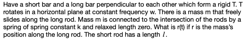

How to break up kinetic energy for circular motion?
In summary, the total kinetic energy of the system is equal to the sum of the kinetic energies of the individual particles.
Nate Stevens

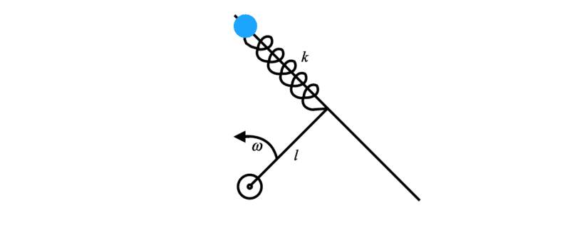

L = T-V
For constant frequency tangential velocity is (radius)*(w)
I need to find r(t) using the Langrangian L = T-V
I just was not sure whether I am on the right track for calculating the total kinetic energy for the above system correctly.

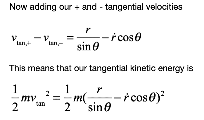

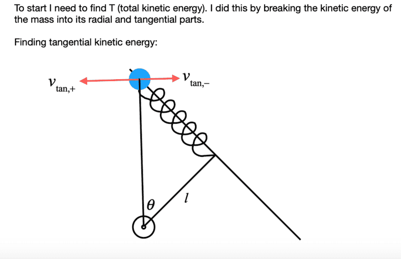

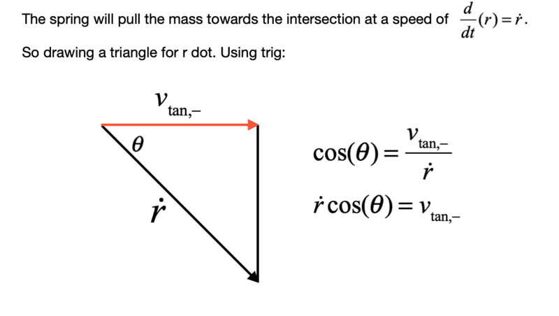

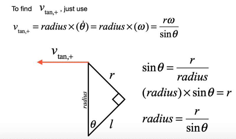

Have I done okay so far?

##\dot r## should be positive when r is increasing. You seem to be using it the other way.
In calculating "vtan,+" you lost ω somewhere. As a result your final equation is dimensionally inconsistent.
Didn't I account for r dot's negative sign when adding "vtan, +" and "vtan, -"? (you are right though that initially I didn't attach a negative sign, which is incorrect) And good catch on the ω. I just dropped it when plugging into (vtan, +)-(vtan, -).
You had not defined that subscript notation. I was reading the first sentence of the second image: "the spring will pull the mass towards ..."
Also, that is not what you mean. It has nothing to do with the spring's pull. It is simply that changing r leads to a component of the particle's velocity in the tangential direction.
What I did not pick up is that you also have a sign problem with the other contributor. The way you have defined θ and ω in the diagram, ##\dot\theta=-\omega##.
Bottom line, increasing r contributes a leftward motion and positive (anticlockwise) ω does likewise, so your final equation should have +, not -.

I like to do these things in the most straightforward way, avoiding too much "thinking" and fancy geometry. So, I would write the position vector for the center of the long rod as ##\vec{x}_c(t) = ( l \cos (\omega t), l \sin(\omega t))## ---- assuming that the center is at ##(l,0)## when ##t = 0.## The perpendicular direction along the long rod from its center is ##\vec{d} = (-\sin(\omega t), \cos(\omega t)),## so the position vector of the mass at time ##t## is
$$\vec{r}_m (t) = \vec{x}_c(t) + r(t) \vec{d} = (l \cos(\omega t) - r(t) \sin(\omega t), \ \sin(\omega t) + r(t) \cos(\omega t)) \hspace{3ex}(1)$$
You can find the velocity ##\vec{V}_m (t)## of the mass by differentiating wrt ##t## in equation (1). Then you can expand and simplify to obtaing a pretty nice expression for ##V_m^2, ##. The resulting total kinetic energy is quite simple. I did not bother to try to separate the kinetic energy into radial and tangential components, because I could not see any reason for doing so.
