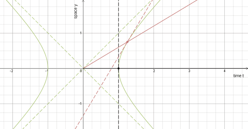

My answer to "Aren't all limits a special case of a particular function?" is NO.
In 1+1 Minkowski spacetime, a lorentz boost (in rectangular coordinates with natural units) is symmetric... a Galilean boost is not.
Yes, when you write the Lorentz Transformations in a certain way and then take the limit of this "maximum signal speed parameter" as it goes to infinity,
you can get to the Galilean limit. (If you write it a different way, you get the so-called [Lewis] Carroll limit. So, what you write down [to describe what limit is being taken] before taking the limit is important.)
These are discussed in http://scitation.aip.org/content/aip/journal/jmp/9/10/10.1063/1.1664490

Although the simulation already starts at the "E=1" case [the punchline],
I would start with the "E= -1" case, then "E=0" case.
(Based on an earlier post of mine https://www.physicsforums.com/threads/minkowski-diagram.876359/#post-5503686 )
https://www.desmos.com/calculator/ti58l2sair [my t axis is horizontal ]
The Lorentz Transformations mentioned above preserves the unit hyperbola (that is, under that Lorentz Transformation, the events on the future unit hyperbola are mapped to the same hyperbola), whose asymptotes are lightlike---that is to say, all frames of reference agree on the same value of the speed of light (maximum signal speed).
An inertial worldline (the t'-axis) drawn from the "center" of the hyperbola into the future light cone intersects the hyperbola at an event.
Think of this worldline as a radius vector from the center.
The tangent line to the hyperbola here is "spacetime-perpendicular" (perpendicular in Minkowski spacetime geometry) to the worldline.
Think "tangent to a circle is perpendicular to radius".
Physically, this tangent line determines the x'-axis... That observer's "space" direction is perpendicular to that observer's "time" direction.
Additionally, this tangent line has the "same value of t' " for that observer---this is that observer's line of simultaneity.
Try changing the E-slider... to the Euclidean case (when E= -1) and the Galilean case (when E=0).
