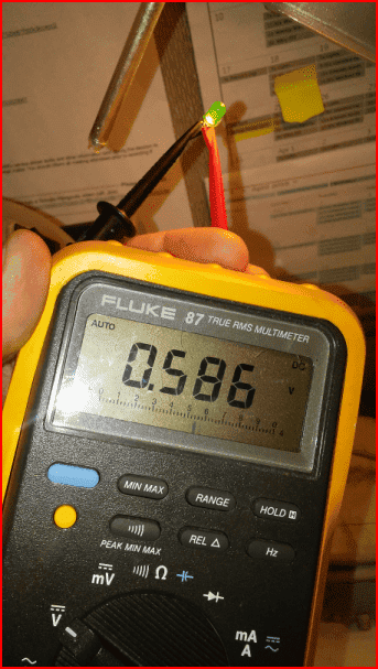

berkeman said:
Not true. Hook an LED to a DVM and shine some light on the LED -- you get a voltage from the photocurrent flowing through the DVM's measurement resistance. :smile:
There's an important reason to use at least a few volts of reverse bias across the photodiode -- it has to do with bandwidth. Do a little Google searching to see if you can find a good explanation of that, and post it here. :smile:
LED under a lamp with DVM measuring the voltage (Red positive lead on the LED anode):
Actually I tried connecting the photodiode to a digital multimeter and shining a 5 milliwatts laser pointer onto the photodiode. The measured resistance Didn't change.
I have worked with operational amplifiers before.
Measure junction voltage with the DVM, not resistance.

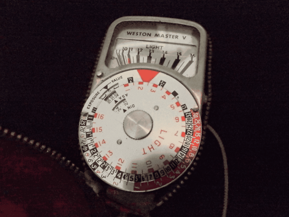

The usual light meter / Laser power meter, is a photovoltaic cell, such a Selenium photo cell or a Silicon photo cell, connected to a load resistor and a moving-coil meter.
Since the photovoltaic cell current output is proportional to received power, the load resistor is connected across the cell and the meter reads the voltage.
Here is an old photographic exposure meter based on that principle.
Some (all?) of the exposure meters just use the resistance of the meter as the load, avoiding the additional load resistor.
On simple Laser power meters you change ranges by switching in different load resistors.
The main advantages of this approach are no battery or electronics are needed, very low cost, and the cells have enough active area that you don't need any optics to focus the Laser beam to a tiny photo diode.
A DIY meter will of course require calibration, that's why most folks buy a digital power meter. Google showed one for US$35 when I searched for 'camera exposure meter.'
Cheers,
Tom
Edit: added photo, reference to Silicon cell
p.s. the circular dial on the exposeure meter is just a circular slide rule to compute camera aperture and shutter speed, based on light level and film speed. It has no electrical connection to the metering function.
Likes dlgoff and berkeman
