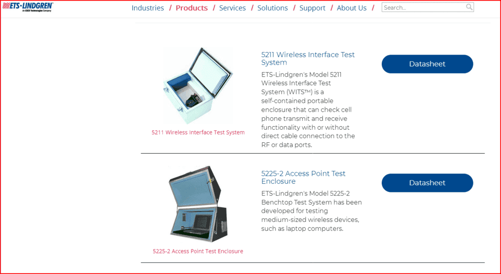

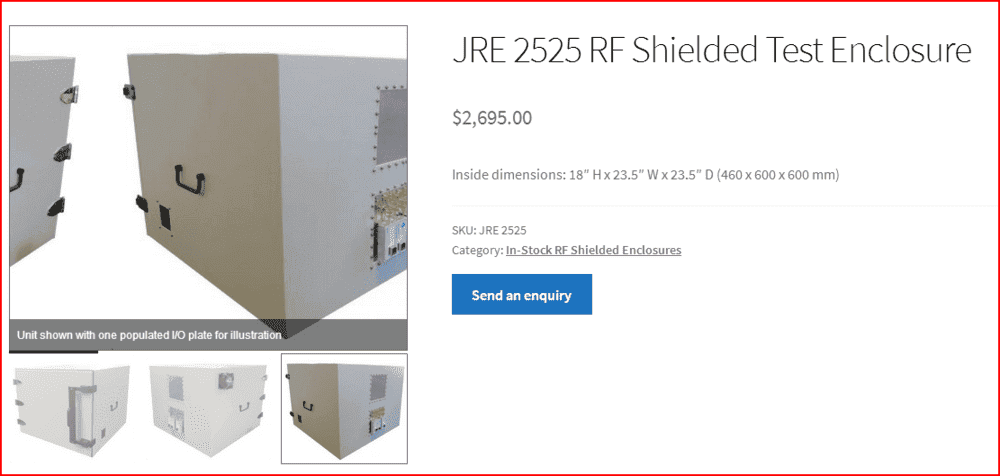

Here is a good baseline for RF shielded enclosures:
https://jretest.com/product/jre-2525/
242362
and this: http://www.ets-lindgren.com/products/test-enclosures
242363

As a follow-up to my post #4 where I showed typical RF shielded enclosures that I work with, I should have mentioned that it takes two of them to perform good, accurate link budget testing at WiFi frequencies. We use two of these enclosures connected by coax with variable RF attenuation between them to see how good our link budget is with our WiFi products (how much RF attenuation does it take before your RSSI and SNR are unacceptably low).
We found we could not just use one box with a device inside and another device outside the box, because the one box setup only provides about 60-70dB of attenuation. Our devices work down to around -85dB, so the second box to house the second device is necessary.
