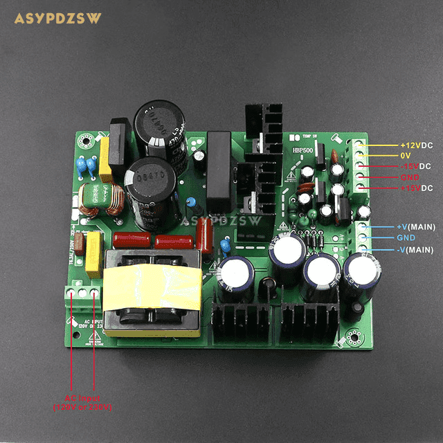

That's pretty impressive, if it works. I don't think I've seen that energy density in an SMPS transformer before. Even running around 1MHz, I'd expect a larger transformer to be needed. Can you publish your test results here when you get it working?
Here is a picture of an SMPS that advertises 500W total output:
https://www.aliexpress.com/item/32832089254.html
https://ae01.alicdn.com/kf/HTB1XMYR...-board-Dual-voltage-PSU-board.jpg_640x640.jpg

I always figured flyback were not really practical above a few hundred W, not because you can't make it work, but because as power comes up device losses catches up on you fast, double power is double current (assuming same voltage) means conducted losses are 4x. This is compounded by the large voltage stress it puts on the primary switch compared to other topologies, now you have poor rdson and higher current...
At some point switching to half or full bridge type topologies is better even given the extra complexity due to the voltages impressed on the device being lower and importantly clamped...
Maybe FETs getting better every other hour moves that point around a fair bit.
Yes, I agree. That is the conventional wisdom. One of the biggest advantages of flybacks is they are cheap, but only at low power. Fewer parts under (relatively) higher stress is a good choice at low power. At high power the stresses matter more than component count.
