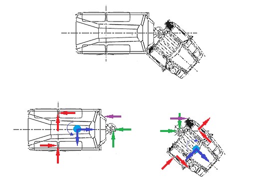

Ok so for a project of mine I need to calc. the force required to steer an articulated heavy on road vehicle and to overcome friction (so I need to calc frictional forces too). I understand I need to draw FBDs but it has been a while since i have done that and I have never worked with an articulated vehicle and it is very confusing for me.
I have been told that this can be worked by using only one side (left or right) of the vehicle as it is a dual-cylinder setup and calculating moment about center pivot. Is this moment the turning force? Actually, on second thought it would not be as it is a torque but how do I use that to get the turning force?

What will happen is the following: The midpoints of the front and rear axles will stay in place, the axles rotating about their respective midpoint as your articulate the vehicle.
This means that the wheels are in pure rolling. Hence the only resistive force is rolling resistance. You can get some rolling resistance coefficients values here as well.
Because - on the same axle - one wheel turn one way and the other, the other way, this will create a torque on your FBD. The other axle will create another torque, but in the other direction. So the input torque needs to be as high as the sum of these torques to initiate/maintain motion. Higher torque will create a greater rotational acceleration. So you will also have to define how fast you want this motion to happen to determine the turning force needed.

After looking at it some more, there will be some lateral displacement of the axles too. This introduces lateral friction which can be defined with the coefficient of friction of the tires.
After that, you need to do the FBD for both parts of the vehicle, each having its own mass and moment of inertia. For example:
RED: rolling resistance and lateral friction;
GREEN: Reaction at pin (same for both);
PURPLE: Input force from hydraulic cylinder (same for both; I've put only 1 cylinder);
BLUE: acceleration (linear & rotational) at CG.
I would start with something like that.

So what I did was use the lateral force with mu=0.7
i then calculated the moments of both axle centres (this uses the small values of rolling resistance forces)...turns out you use the whole axle as the opposing directions of the rolling resistance forces actually double the moment not cancel it.
I then noted down these moment values...one was negative the other positive.
then I 'removed' the axles and treated the rest as a single beam with pivot at centre..i then calculated the moment about the centre summing the axle moments with the frictional forces*dist to pivot.
This gave me a reasonable answer of 30 000 Nm
The hydraulics provide 48 000 Nm at the pivot which is more then enough to overcome friction.
But...The 30 000 Nm is the torque required to only just get the vehicle turning right? But then this should be the max value since it is overcoming static friction and once turning at a stand still (and also while moving at speed) the torque required should be less
So, the extra torque supplied by hydraulics could be some sort of safety factor, having more than what is needed? Or would the extra value be there to get a certain turning velocity??
Yes, whatever force/torque that will exceed what is needed will translate into an acceleration of the motion; F=ma, T=Iα.
