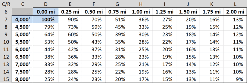

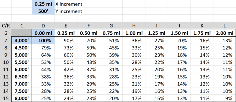

Based on that, I came up with a little table showing how the sound is reduced as a funtion of the position of the plane. The blue cells are the initial conditions.
Column C is the Y1 values. C7 is Y0. Row 6 is the X1 values. D6 is X0. I chose 4,000' for Y0 because that's the altitude of the planes that pass over our neighborhood. D7 is 100% of whatever the noise is at (X0,Y0), which is at distance Z0 = SQRT(X0^2 + Y0^2).
I did this with percentages. I thought that would be more meaningful to the average user. I suppose I could convert it to dB provided that I had an initial dB value. If I understand dB, the reading in D15, where the sound is down to 25% of the original, would be down 6dB. Is that correct?

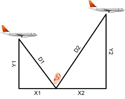

The position is determined by this diagram:
Here's the VBA code that does the calculations in Excel:

OK, but if I am comparing the noise level at a fixed position for both the ear and the plane, moving the plane would not affect the calculations significnatly, no?
The value at the top right (overhead at 4k) value of 100% would be 0dB and all the other values would be negative dB 'cos they're less than 100%.
Yes - 25% is 0.25. I sympathise if you need to talk to non-technical neighbours.
Wes Turner said:
although isn't 10 dB about a 90% reduction?
Yes - or, better still, a ratio of 0.1. In the case of noise nuisances like this it's fair enough to use percentages but for levels and not for 'reductions'. However, your second quote demonstrates where percentages can be seriously mis-used and mis-understood. People will not / cannot always do the calculation.
Percentages are fine, when used in the context of small price reductions (and small changes in general) but it's possible to look at that "90%" you quote and mis read it as 'down to 90%'. Also, what would 'reduced by 99.9% mean (=reduced TO 0.1%) or 'reduced by 99.95%? Not a problem when we are all in the know about what you mean but it can be used (sometimes deliberately) to mis-lead a reader. Your table is fine and shows the pattern. It shows that height is very relevant near the airport. One small niggle would be that the Table is missing a proper title to say what the sound level value units are (Power or Sound pressure). The values could be very different if your calculation was one way or the other so you should state what they actually are.
I have a similar problem with expressions like 'ten times less'. We all learned fractions in school so why not 'one tenth' - or would '1/12.5' be replaced by 'twelve and a half times less?. Just an old gimmer's whinge - but relevant imo. The OP has avoided this problem.
Likes sysprog and Wes Turner

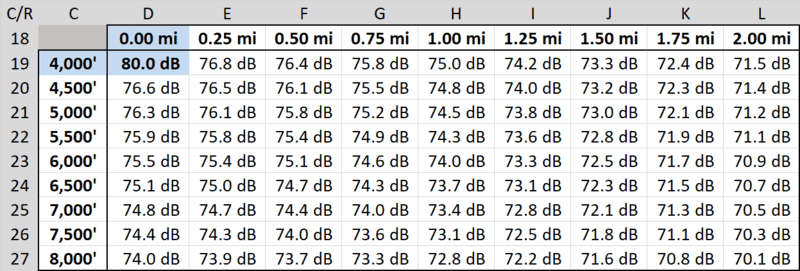

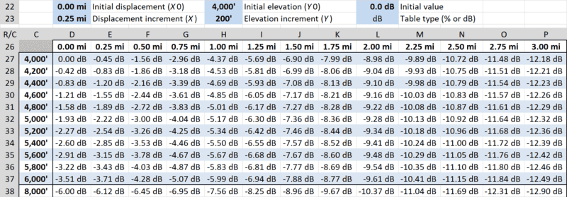

I do not understand this. The 100% value in cell D7 is intended to indicate 100% of whatever the noise level is at those coordinates, in this case, 4,000' overhead and 0.0 miles to the left or right. The rest of the percentages are to indicate what the noise level would be relative to those initial conditions.
I replicated the table to do dB calculations. These are the estimated dB readings that correspond to the % readings:
Compare that to these % readings.
And these are the predicted dB readings for an initial reading of 80 dB.
It looks like it is easier to get a meaningful reduction by moving the flight path left or right than by raising the elevation. In many cases, that just means moving the noise to a different neigborhood. In our case, there is water about 1-2 miles away that leads right up to the runways.
I obviously didn't make it clear enough; sorry.
100% is 1.000. Log(1) is zero so 0dB top left. You need too express / convert the percentages as decimals and then do 10log(the decimal value). The dB scale is a scale of Ratios and nothing on your (decimal) table is greater than 1. The dBs will then go from small negative values at the top left region and be more and more negative as you move right and down. (logs of numbers less than one are negative - stick with this, you'll get it.)

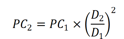

I think we are talking past each other. My % table is intended to show the relative sound levels for various increases in distance. I am not taking the log of anything in that table. It's just a simple inverse square relationship. Yes, 100% is 1.000, but it's what it is 100% of that matters. It's not the 100% itself.
That equation is:
where D1 & D2 are the line of sight distances from the ear to the planes.
In the dB table, I start with any dB level at D1 and calculate the decibel level at D2. That equation is:
Let me know if I made any errors. (I just fixed a typo.)

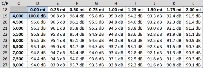

The dB figures you get for 6000' and 1 mile are 6dB less than the starting values in your tables so the basic calculations are correct, OK? If you actually knew all the characteristics of a particular plane then you could perhaps calculate 'real values' for that table but you'd need to do some actual measurements at various places (hot air balloon?) to calibrate the table.
Starting with the 100dB or 80dB figure is, as @berkeman implies, arbitrary because both those numbers are arbitrary. The thing about deciBels (and, indeed Bels) is that they are Relative numbers. One aeroplane will have a different actual noise level from another when it's at 4k and zero distance. The sort of table you are drawing up is basically intended to show how any plane's noise level will vary, relative to the 'starting point'. So the conventional (and most helpful) thing is to start with a common value of 0dB and the only reason for doing otherwise would be if you actually knew the actual noise values, in which case the dB would be relative to the 'accepted' threshold of hearing level. That's the basis of the dB in acoustics. For electrical signals, the absolute level will often be written relative to a Watt (dBW) or milliwatt (dBmW) or even microWatt (dBμ) but I guess the Sound Engineers got there first and bagged the 'absolute dB'.

Then either start with a realistic dB level or start with a reference level of 0dB. Starting with a 100dB level for a plane 4000 feet overhead makes no sense to me. Do you know how loud that is?

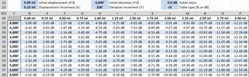

You make a good point. Here's the table starting at 0 dB:
That does make it easy to see the reduction.
I chose 100dB just as an example as it made it each for me to confirm the calculations.
I attended a meeting recently where some people were claiming noises close to 100dB at their homes. The airport authorities and the city reps did acknowledge readings as high as 80dB at some of their listening posts, one of which is just a couple of blocks from my home. I have never (or rarely) heard anything that loud. The music from the amphitheater 4 miles away and the stupid kids and their fireworks are much louder.
Anyway, thanks for the suggestion.

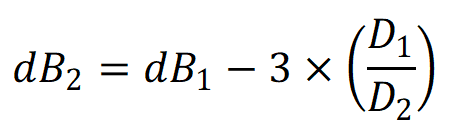

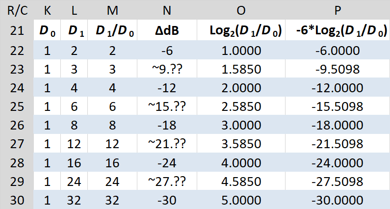

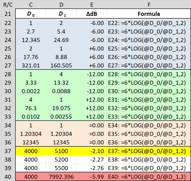

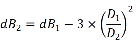

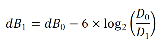

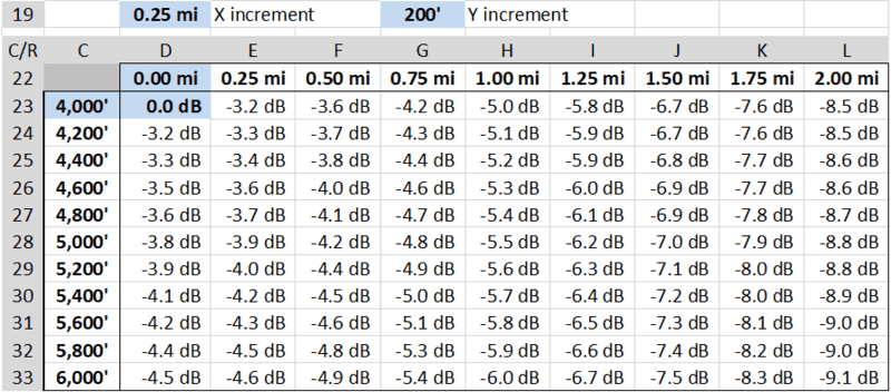

It looks like I had an error in my formula for calculating the difference in decibel levels as a function of distance. If I understand it correctly, doubling the distance should subtract 6 dB.
I believe the correct equation is:
Here's a new table with what I believe are the correct values using that equation. Column C has been named D_0 and column D has been named D_1. The @ sign is Excel's new way of selecting the cell from a range that is on the same row or column. The second parameter of the Log function is the base (2).
The first set in blue are all factors of 2, which should be a change of 6 dB. The next set in green are all factors of 4, which should be a change of 12 dB. The next set in light orange are equal, so no change in dB.
The next set are from the city table.
The last line (row 40) is interesting. Sophie commented that my caluclations were correct because the value I showed at 4,000' and 1 mile was -6 dB. Those parameters are for a right triangle with sides of 4000 and 5280. That makes the hypotenuse 7992.396 (=sqrt(4000^2 + 5280^2), which is just close enough to 8000 to return a 6 dB result. If I had shown another decimal place, it would have been 5.99 as in the table above.
That changes the values in my larger table a bit.
Now we see the value in H37 as -5.99 dB. I added the 8000' row (38) so we could see that at 8000' and 0 miles, the distance is exactly double and the table shows -6 dB.
I believe these values are now correct. Please let me know if you see any errors.
Thanks
Where did you get that formula for calculating dB? You may have read someone’s workaround for a particular case but why not use the formula with log base ten?
look at Wiki for all you need to know about deciBels and for the right formula.
I’m not being difficult or elitist here.
Likes Wes Turner
dB1 = dB0 - 6.0206 * Log2( D0 / D1 )
Now change the base from 2 to 10.
dB1 = dB0 - 20 * Log10( D0 / D1 )
Likes Wes Turner
Baluncore said:
We all know how to change the bases of logarithms but, apart from in Maths exams, is there any point? There are more steps in the calculation and I still question where the OP found this method and why he chose to use it. Does it get anyone anywhere useful?
It's a 'correct' version. But why bother? It's only re-arranging the basic formula by using log base 2 instead of log base 10, introducing an error because 6dB is not the exact value and you have to introduce another term in your formula.
I used the percentage table you showed just above it and I read the value in that cell as 25%, which is 6dB lower than the start cell in all your dB tables. Hardly surprising and it checks out.
Your tables would be handy for getting a rough idea of how distance and height is likely to affect what you hear but, the angle changes a lot (reducing as the plane goes further away) so it would be risky to quote those values in a dispute because they are very approximate and could affect your credibility. If more detailed evidence is available then that's what you should quote publicly.
Likes Wes Turner
I believe that Alexander Graham Bell found that a sound appears half as loud when it is one tenth the power. This is one Bel or 10 decibels. So a 10dB reduction will sound half as loud.
By increasing the distance about three times, the aeroplane will sound half as loud.
Likes Wes Turner
  • #31
But not half as annoying.
  • #32
The way I get pretty much everything -- by the seat of my pants.
I looked at a bunch of websites, including Wikipedia. I was too lazy to go through all of the math and physics having to do with pressure vs voltage vs who knows what. But the phrase that I read over and over, including here, was that you double the distance and you lose 6 dB. It was pretty easy to come up with my formula from that:
What I didn't realize, and what most of those sites failed to make clear (not Wikipedia) was that it was approximately 6 dB.
I am surprised that someone like you who rails against those who confuse 3 times larger and 3 times as large, one of my minor pet peeves, would not point out that it is only approximately -6 dB.
I have fixed my table. It now looks like this:
Not at all. I have no problem with you pointing out errors in my math or my logic. I appreciate it. And the tone doesn't much matter to me as long as the commentary is correct. :wink:
Likes sophiecentaur
  • #33
Thanks for that correction. I have now found that equation on several websites as well. And I just posted my corrected table.
Thanks
Likes Baluncore
  • #34
I think this is the key point -- or two points really.
First, I really don't care whether the sound is louder as the aircraft is approaching, directly overhead, or going away. I only care about how loud it is at its loudest point. And unless that is a significant distance from directly overhead so that the line-of-sight distance is significantly greater, it doesn't matter. In addition, the aircraft are on a glide path -- that is, descending. So that will offset at least some of the increase in the distance after it has passed by. And finally, the sound monitors that they have placed in three spots around the city are recording the maximum volume, which is all that the neighbors care about. But unless they are close to your house, the sound you hear would be different.
Second, and this is more important, several comments on the websites and here suggest that the human perception of volume is subjective on several levels, so any instrument reading may not be a perfect measure of what one person or another would perceive.
In short, all I am trying to do is provide a way to measure the relative impact of increasing the elevation of the glide path, moving it farther away, or some combination of both. I argue that whatever the limitations of the numbers in my tables, they can do that job. And in fact, I argue that the percentage table is probably the best at that task. I have heard no complaints about incorrect equations there. It makes it quite clear that moving the glide path 0.75 miles away has the same effect (~50% reduction in volume) as raising the flight path by 1,600', something that the guy from the airport seemed to say was highly unlikely. Furthermore, raising the glide path by the recommended 1,100' and moving it 0.75 miles away will reduce the volume by over 60%.
Do you take issue with any of that?

  • #42
Wes Turner said:
Now you are just being childish.
No, just obtuse, in response to a lack of information.
So where then is the 1,100' or 1 mile specified ?
  • #43
Jeez, man. I've said several times that the city scheduled a town hall meeting with representatives from the airport and FAA to discuss the installation of the GBAS and how it might enable the airport to make changes to the glide paths. They said that the current glide path puts the aircraft about 4,000' above and pretty much directly over our neighborhood. They also said that they think they can increase the elevation by about 1,100' and possibly move it a mile or so to the east, that would put it over a large body of water.
This is interesting. Yesterday, I came up with this equation that calculates the perceived sound as a function of distance.
It appears to work as illustrated by this table, which calculates the percentage of the perceived sound at D0 that is perceived at D1:
The distance at H23 is sqrt(10) and the percentge is, at predicted, 50%. The distance at L23 is 10 and the percentage is, as predicted, 25%.
But I can't remember how I got to that formula.
Can you tell me if it is correct and, if so, the derivation?
Thanks
PS: That table only shows the distance in one dimension. I didn't want to burden any of you with my "voluminous" tables. :smile:
  • #47
I used the formula above to add a third table.
The top table (rows 6-9) show the percent reduction is sound pressure (power?) as a function of distance. The middle table shows that same change units of decibels. The bottom table shows the percent reduction in the perceived sound volume according the the formula above based on Bell's observation that it takes a reduction in sound pressure to have a 50% reduction in the perceived volume.
Rows 7, 15, & 24 all contain the the same values representing D1. The distance in Column D is sqrt(2), at which point the sound pressure is reduced by half. The distance in Column E is 2.00, at which point the sound pressure is reduced to 25%. The distance in Column F is sqrt(10), at which point the sound pressure is reduced to 10% and the sound pressure is reduced to 10% and the perceived sound volume is reduced by half. The distance in Column I is 10, at which point the perceived sound volume is reducved to 25%.
Any comments on this? Is it accurate (at least to a first approximation)?
  • #48
Only my previous comment about trying to make the whole thing rest on a very simple model of an omnidirectional source in free space, neither of which you've got with an aircraft. I'd go along with it , fine but an 'expert' could inject a damaging amount of doubt into the validity of those figures. Could involve shooting yourself in the foot.
  • #49
As I replied to you last time, I don't have a "foot" in this fight to get shot in -- by me or anyone else. I am just trying to provide the best tool for estimating the distance required to achieve some desired level of backyard quiet. I know it's not perfect and my neighbors know that also. I don't think we have to keep beating that horse.
In short, my central question, now, is this: Is Table 3 above based on the comment from tech99 about Graham Bell's observations the "best" estimate of the "perceived" sound volume as a function of distance? Notice that I put both "best" and "perceived" in quotes so as not to get your knickers in a twist over it not being perfect.
If not, is there a better way to get that estimate that does not entail connecting the plane to the ground with a giant measuring tape and placing drones every meter along that tape to measure temperature, humidity, particulates, ambient noise, wind direction, and the gravitational pull from Pluto?
Thanks
