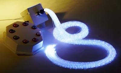

A bundle is just a bunch of individual fibers packaged together, unless you are referring to something else. Can you post a link or a picture of what you are looking at? Thanks.
I understand it as for image/light you would need a bundle of optical fibers rather than one. Basically I want to know how does increase in the number of optical fibers affect the light being transmitted.
In general, it does not, AFAIK. Are you referring to individually clad fibers as used in a telecommunications cable (first pic below), or the unclad fibers used in simple bundles (2nd pic below)? Again, if you could post links or pictures, that would help us.
https://www.e-driver.net/images/8294005_m.jpg
https://www.especialneeds.com/media...c6a9728ccd/l/e/ledFiberOpticBundle-main_6.jpg
