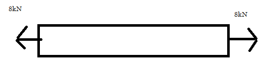

In the question below, is the average normal force in order to calculate the average normal stress, 8sin60 or 16sin60 or 0?

OK the free body diagram is this;
What do you think it is
I think it's zero, because at that point, the two opposite forces are cancelling each other
The stress is not zero because there are forces pulling the bar apart.

ok then it's 16sin60
No, it isn't.
Where does the sin 60 come from?
Do you know what the definition of "stress" is?
