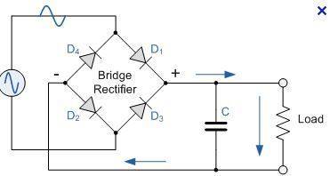

Hi guys
I'm working on a few questions regarding the full wave rectifier circuit similar to the attached image.
The AC voltage is 12v at 110Hz, the ripple voltage is 1v peak to peak and the load current is 24mA. I am to assume each diode has a forward voltage drop of 1v when conducting.
I have to find:
1) The length of time the capacitor is supplying current to the load for if the diode conduction angle is 20 degrees.
2) Value of capacitor required to produce the 1v peak to peak ripple voltage.
3) Average power dissipated in the load.
For question 1, I found the period = 1/(2*110) = 1/220 = 4.55ms, then dt = 4.55-(4.55/6) = 3.79ms. Where (4.55/6) was the period of the capacitor charging.
For question 2, I then used I=c(dv/dt) and transposed for c = I(dt/dv). Therefore c = 24x10-3*(3.79x10-3/1) = 90.96 micro Farads.
For question 3, I used P = I*(Vac - Vdrop) = 24x10-3*(12-2) = 0.24W. This doesn't seem right to me.
I'd appreciate your help as I'm not confident that any of them are correct.

Is the 12V rms , amplitude, pk-pk or what?
Is the 24mA the average load current?
Define "conduction angle". Is it 20 deg of 180 deg or 360 deg? (NOTE: 360 deg would be 1/110 Hz which is the period of the excitation voltage. Be real careful with this.

Obviously not right. You will get a much clearer idea of what you are dealing with if you sketch the graph of the time-varying voltage across the load resistor. Hint: the voltage across the load is identical with the voltage across the capacitor.

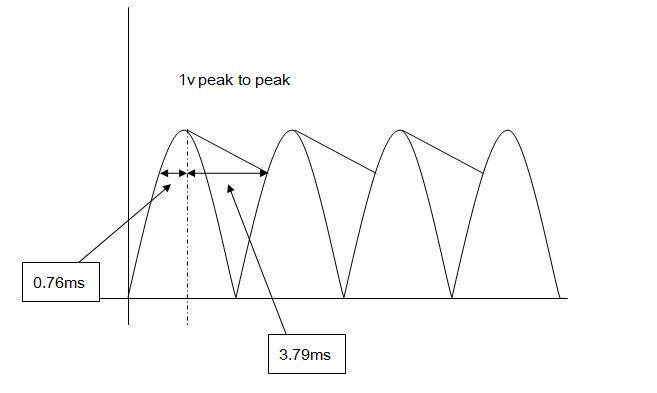

Something like this?

That's probably the waveform. Once you know the voltage waveform, you can estimate the power.

The two levels would be 11.5 and 12.5v, right?
No. Remember, the AC supply is given as 12v RMS.
I haven't integrated this stuff before but I'll try and follow the advice and see what happens!
I doubt that any integration is intended in this exercise.
Ah ok. So then I need to multiply by the square root of 2. I also need to take away 2v for the diodes and then 0.5v for the average of the ripple?
I think you're right about the integration by the way.
That should give a very close result.
this is close but the decay does not start at the peaks.
