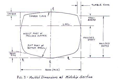

Thanks, but what should I do to find the centerline of the boat?
The centerline of a boat is a reference plane which is established when the boat is designed and built. It is not determined by calculation in most circumstances. The centerline establishes the location about which the breadths of the vessel are symmetric:
The centerline is indicated by the C and the L superimposed.

The centerline of a boat is still the reference plane about which the breadths of the vessel are geometrically symmetric. That the construction of the vessel has left it with a center of gravity which is offset to one side of the centerline is immaterial.
