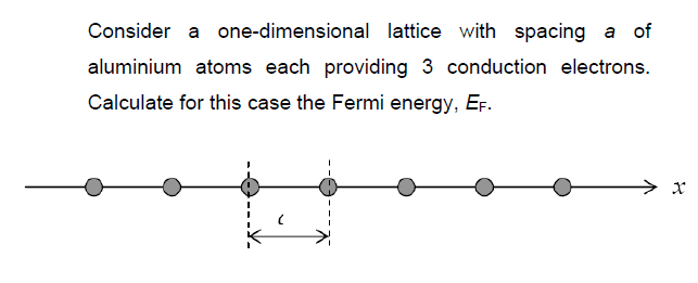

Hey I have a question pictured below:
I always seem to struggle with questions like these, my understanding is we know the spacing of K-states throughout the lattice is given by
[tex]\frac{2\pi}{L}[/tex]
Such that the fermi wavevector divided by this spacing and multiplied by 2 due to the fact there are 2 electrons per k-state gives us the total number of electrons:
[tex]N=\frac{k_{F}}{\frac{2\pi}{L}}\times 2[/tex]
We also know that the total no. of electrons is given by the electron density multiplied by the the length of the lattice
[tex]N=nL=\frac{3L}{a}[/tex]
Where I have said the electron density is equal to 3 conduction electrons divided by the unit cell length.
Equating the expressions to eliminate 'N' I attain
[tex]k_{F}=\frac{3\pi}{a}[/tex]
Which to find the fermi energy I think I'd just use this equation but I'm not sure?
[tex]E_{F}=\frac{\hbar^{2}k_{F}^{2}}{2m_{al}}[/tex]
Where 'm_al' is the mass of an aluminium atom?
Though I'm not sure I've done this correctly... I think I may need to have the fermi wavevector divided by 2 for it to be correct - not sure why I would need to do this though.
Anyway thanks for any help!
SK
You want to use the mass of the electron rather than the mass of the aluminum atom since you are considering the energy states of conduction electrons.
Electrons can travel both ways on the lattice, so the allowed states cover negative as well as positive values of k. So, the range of k will be from ##-k_F## to ##+k_F##. Maybe this will fix your missing factor of 2.
[EDIT: I was assuming periodic boundary conditions for the lattice so you are dealing with running waves that can have + or - k. If you are using fixed boundary conditions so that you are dealing with standing waves, then you will have only positive values of k. But then the spacing for k will be ##\pi/L## rather than ##2\pi/L##.]

Overall, your calculation looks good to me except that if you are going to use periodic boundary conditions so that the k-spacing is ##2\pi/L## then the range of ##k## will be from ##-k_F## to ##+k_F##. So, the extension in k-space is ##2k_F##. Then your equation ##N = \frac{k_F}{2\pi/L}\times 2## would become ##N = \frac{2k_F}{2\pi/L}\times 2##.
I understand now what I was doing wrong, thanks again for walking me through this!
