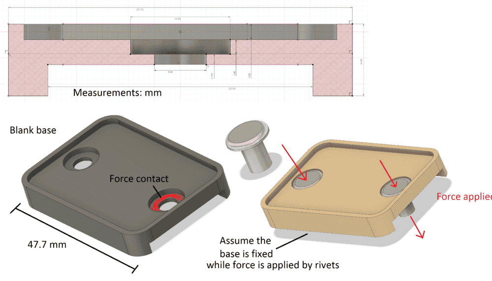

In summary, the attachment illustrates a simple riveted joint. The rivet is used to demonstrate the stress being applied to the extruded-cut round part of the epoxy piece. The rivet is merely a point of application for the stress, and is not the actual stressors. The actual stressors are the load and geometry of the structure.
tellmethetruth
TL;DR Summary
I need to calculate how much force a part can take before breaking.
I'm trying to learn some new engineering, so if something I ask doesn't make sense -- remember I'm new to this.
Material: resin (Flexural Yield Strength: 6752 psi) - (Tensile Strength: 3390 psi) - (Density [lbs/gal]: 9.64) - (Durometer Hardness: 78) -- if this isn't enough info, substitute your own material as an example.
Force: variable (make any up), applied by rivets onto contact surface (refer to attachment link for specifications) ibb.co/b2d7T87 (for higher quality pic)If someone could at least give me the steps needed to calculate this.

What calculation would I need to determine the breaking point? Please refer to the attachment posted.
Are you asking this in regard to the simple riveted joint illustrated in the attachment, or some other structure?
Yes regarding the rivet in the attachment. This wouldn't be a traditional steel rivet joint, but a 2 piece screw rivet.
I'd like to know how much force it takes until the bottom head of the rivet, breaks/deforms the epoxy resin part (highlighted in red).
The rivet is merely to demonstrate the force being applied on the extruded-cut round part of the epoxy piece.
OK. Now we need to identify all the possible failure modes of this structure given the illustrated geometry and loads applied. This will help you find the 'weakest link' in your design.
In what ways do you think the structure might fail? Please be very precise. Try to visualize the actual failure interface (paths and directions). Also identify any distortions that might be caused by twisting, bending or flexing of the structures during the application of the loads. Identify the loading characteristics. Is the load applied slowly or rapidly? Is it intermittent, cycling, or steady state? What is its periodicity?
All of the above will allow you to calculate the strength of the structure in each of the possible failure modes identified and thereby provide data for the selection of materials for the structure or to evaluate the suitability of the given materials, or to point out the need for a redesign.

The bottom face of the rivet head that's in contact with the part during the force taking place, will first deform and eventually break, as the center between the two holes begins to deform from stress.
All sharp angle corners will create a weak breaking point. There won't be any torsion force, just a static non-linear load.
The steady load is applied "slowly", relative to a shock force. Periodicity = 1.
What I'm really looking for is equations that can provide empirical data, that will allow optimization of material, thickness, etc.
