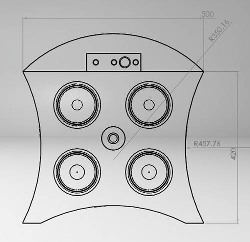

So I have this design of a speaker system for my Product Design course in A-Level.
There are 3 arcs in my design that I need to know the length of for when my school orders the materials to my specific measurements.
Here is a picture with measurements of my design from SolidWorks CAD Software.
The arc at the top is 100mm high and the side arcs would be 50mm
All measurements in mm. I hope this is enough info for you to help me!

So you know the radius of a circular arc and you know the length of a chord of that arc.
Can you draw a right triangle anywhere?
Thank you Jed! - I thought it must have a feature to do so! - hence why I added that I had used it.
Thank you very much guys, sorted!
