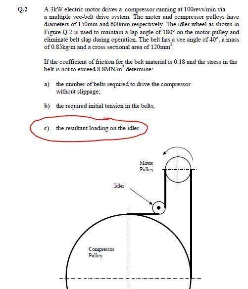

Pkruse said:The square root of 2 times the answer you got on (b).
Just sum the two load vectors up.
