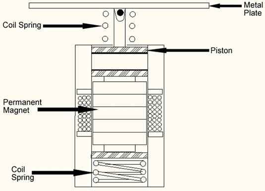

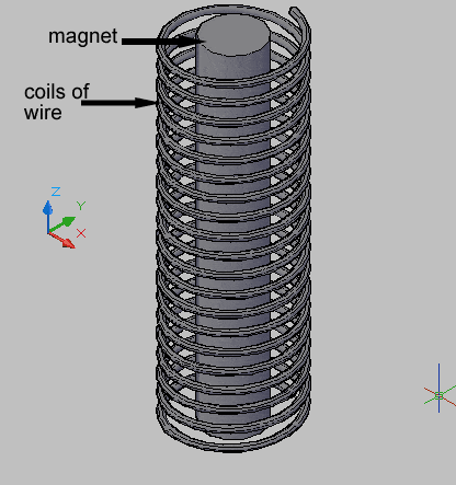

I will appreciate any contribtion to the question below. > You have a system that consists of a coil and magnet. The magnet, which is resting on a spring, is free to move up and down in the coil. This system can be modeled as a simple mass-spring-damper system with a damping coefficient that consists of the mechanical and electromagnetic damping. - the question here is the formula i can use to calculate the mechanical and electromagnetic damping. Thanks as you contribute.

Sorry for my long delay. Preparation for a seminar defence has been tying me down. @jsgruszynski > the lumped circuit equation for the electrical portion is Lq''+Rq'+kq=e(t). That of mechanical portion is mx''+Cx'+kx=f(t). I don't know how to get an expression 4 the damping coefficient, C from here. I know that for a mass-spring-damper system whereby the mass is a magnet that moves in a coil of wire, the damping consists of mechanical and electrical damping coeff. Also, how can I get an expression 4 the power output of such a setup, assumming f(t) to be sinusoidal (eg 5sint) @wil3 > the magnet is not entirely within the cylinder of the coil and the magnet is just slightly smaller than the coil. This system is just like a simple linear generator. >The coil resistance is not actually known but I know it can be calculated from the resistivity & length of the wire. What i actually want to know is an expression for the 2 damping coefficients and the power output when the magnet is moved with a sinusoidal forcing function for example.

I have gone through Fig 4 and section 2.5. Actually I have come across that configuration in one of my ebooks, but the configuration is very different from the one I'm working on. Mine is just a magnet moving in a coil of wire as shown in the diagrams.
Think of the magnetic flux path as a circuit. Broken into pieces, it's equivalent. The bits in the coil are the same as the model's coiled section. The bits outside of the coil are equivalent to the moving iron. There is no actual gap but there is a variance in the partition between [itex]\phi[/itex]l and [itex]\phi[/itex]m based on the offset of the slug.
The magnet's polarization is just an offset to be added in compared to just iron which is a zero polarization offset.
