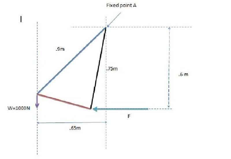

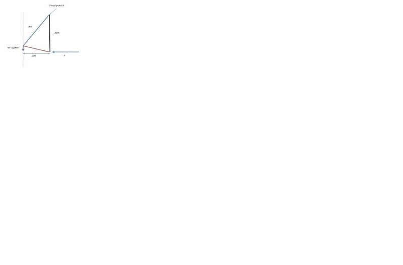

I'm looking at a problem and am having trouble finding the force using moments. To be honest I'm not sure am i going about it the correct way.
Attached is a sketch of the problem,
Is the cclockwise moment about A = .5m(1000N) = 500Nm
and the anti clockwise moment about A = .75m(F)
can these be equated to find F??
Thanks

Your image is too tiny.
Sorry, attached is a bigger image in a word document.

Welcome to PF!
Hi Sully1071! Welcome to PF! :wink:
Yes, that's exactly correct :smile:
(except that you've mixed up clockwise and anti-clcokwise! :rolleyes:)
and yes, you now equate the clockwise to the anti-clockwise.
Why is that worrying you? :confused:
Im just unfamiliar with unfamiliar with these calculations but have to do them as part of a project.
If i use the new free body diagram attached and the unit was to rotate about point a i assume my new moments would be calculated by:
Anticlockwise moments = 1000(.65)
Clockwise moments = F(.6)
  • sketch 1 moments.doc
Hi Sully1071! :smile:
Is this a new problem? …
sorry, I'm on an iMac, and it won't show images in .doc :redface:
(but I could see your original .jpg)
jpeg is attached
ah! nice and big! :biggrin:
yes that's right :smile:
generally, the moment of a force F is the dot product F.d,
which you can do as either F times the perpendicular distance (your method)
or as F times the whole distance times sine of the angle between :wink:
