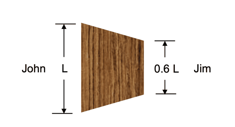

To go back to the original problem, I think that the conceptual goals of the problem can be clarified by first asking part (a) of the problem below. Part (b) is essentially the same as the original problem.
A tabletop of trapezoidal shape (shown on the right) has uniform thickness. John pushes on the tabletop from the right and his friend Jim pushes to the left from the other side so that the tabletop does not accelerate. Assume that the forces are uniformly distributed over the faces and that there are no other horizontal forces acting on the tabletop.
(a) The pressure on left face of the tabletop (John's side) is 200 Pa. What is the pressure on the right face of the tabletop?​
(b) Jim goes over to John's side and pushes to the right with the same force as before. The tabletop accelerates to the right. What is the pressure on the right face of the tabletop now?​
