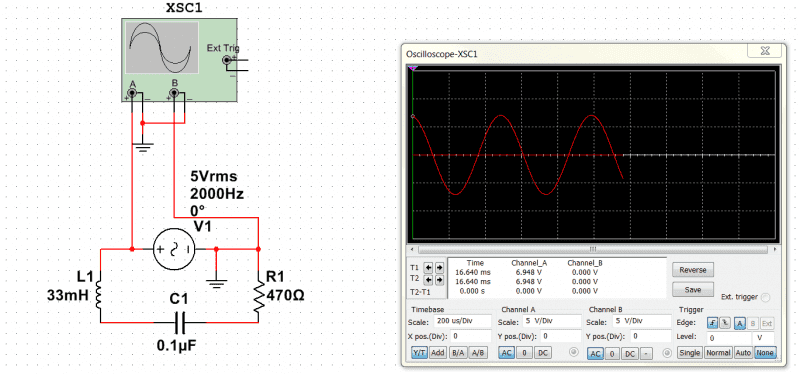

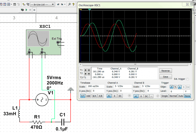

This is actually a lab I'm performing on Multisim. I've recreated a circuit that I build in lab class , but I'm not getting the output I need. I am trying to calculate the V and phase angle across each component. I already have the measurements found form the class lab. In addition to the oscilloscope terminal B not working, I'm not sure how to calculate the phase angle across the cap and inductor.
I know that each angle is -90 for cap and +90 for inductor.
See images
Measured values, but not sure how to apply to phase angle equation to find capacitor and inductor phase angles.
