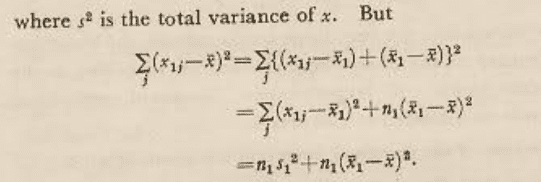

Thanks again He for your swift reply and your own testing. Does this provide any hint on where the problem is?
https://www.physicsforums.com/threa...iation-over-samples-of-different-size.268377/
Below is a clip from this page. Maybe n1S12 is what's missing?
That is a test if different datasets are compatible.The problem is interesting enough for the long way:
