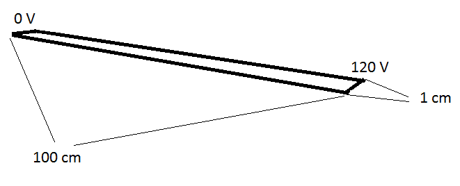

Current in a strip of graphene can be calculated with following equation.
w is the width of the strip
V is the voltage on the two ends of the strip
l is the length of the strip
$$A=1.60217662\times10^{-19}C\times w\times \frac{10^{12} }{cm^{2}}\times \frac{V}{l}\times \frac{200000cm^{2}}{Vs} $$
example calculation
w = 1 cm
V = 120 V
l = 100 cm
$$A=1.60217662\times10^{-19}C\times 1 cm\times \frac{10^{12} }{cm^{2}}\times \frac{120V}{100cm}\times \frac{200000cm^{2}}{Vs} =0.03845A $$
cx_HCCXRpdqQBlzBYa5QQRVZCbqxnQU8sveE2_kJts6ub6_OwemqdzGfG1VOBYGXR1nsX5jZGGQx0LiKcAO0=w1920-h949.png
If you wanted 10 A you would need 260 layers. This would be 18,200 picometers thick or ##1.82\times10^{-6}cm##
