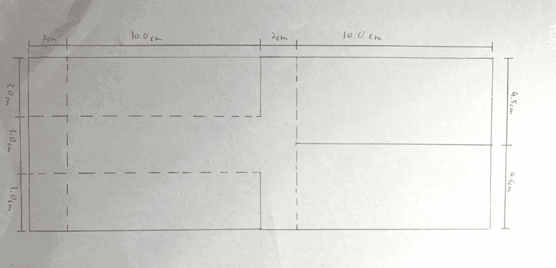

How to make a model paper helicopter
1. Draw the outline of the wings, body, and leg as the following picture shows:
2. Cut the paper around the outer solid lines, which is 9.00cm by 24.00cm
3. Cut along the inner solid lines
4. Fold along the dotted lines (The material around the tail should fold one around the back and one around the front). The wings should be folded in opposite directions.
5. Add the paper clip to the bottom of the tail (the paper clip should hold the folded paper together)

EelAnes said:
How to calculate the drag force...
Do they want a graph of drag versus time (drag depends on which point in the autogiro's descent you are talking about) or just terminal velocity drag?
David Lewis said:
drag versus time
Yes they want a graph of drag vs time
EelAnes said:
How to calculate the drag force of the model helicopter using the given data above?
Above? Do you mean the experimental data further down?
EelAnes said:
D=Cd*1/2(p*V^2)*A
If you are to calculate the drag force from the experimental data then this is not the equation you need.
Are you familiar with the concept of terminal velocity?
Once you have found the drag force from the data, you can use the drag equation above to find the drag coefficient.
I'm not familiar with terminal velocity, so can you show me how it's done base on one of the data set above please?
Write the force and acceleration equation for the drop, including a drag force (that will depend on speed somehow). A high drag item such as in this test will fairly quickly get to the point that the velocity hardly increases any further. This is known as terminal velocity.
What will be the drag force at that point?
If we assume that speed is reached very quickly, how can you find the terminal velocity from your data?
