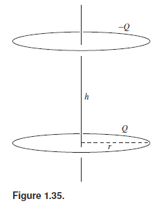

Two rings with radius r have charge Q and −Q uniformly
distributed around them. The rings are parallel and located a
distance h apart, as shown in Fig. 1.35. Let z be the vertical
coordinate, with z = 0 taken to be at the center of the lower
ring. As a function of z, what is the electric field at points on
the axis of the rings?

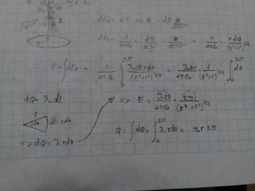

Hi! I need help with this problem. I tried to solve it like this:
First I calculated the electric field of each ring:
Thus the electric field at a point that is at a distance z from the ring is ##E=\frac{Qz}{4\pi\epsilon_0(z^2+r^2)^{3/2}}##, Thuss for the upper ring, the electric field would be ##E_1=\frac{-Qz}{4\pi\epsilon_0(z^2+r^2)^{3/2}}## and for the lower one, it would be ##E_2=\frac{Qz}{4\pi\epsilon_0(z^2+r^2)^{3/2}}##.
Then, I choose a random point between the both rings, at a z height, so ##E_1=\frac{-Q(h-z)}{4\pi\epsilon_0((h-z)^2+r^2)^{3/2}}## and
##E_2=\frac{Qz}{4\pi\epsilon_0(z^2+r^2)^{3/2}}##, so the total electric field would be the sum of both, right? ##E_t=\frac{Q}{4\pi\epsilon_0}\left(\frac{z}{(z^2+r^2)^{3/2}}-\frac{(h-z)}{((h-z)^2+r^2)^{3/2}}\right)##.
The problem is that my answer is wroing and I don't know why. Hope someone can help me.
Note that your expression for##E_1## gives zero electric field at ##z = 0## due the upper ring. That can't be right.
But your expression for ##E_2## looks good. (You should also indicate the direction of the field.)
OK. Here it looks like you have taken into account that the center of the upper ring is not at z = 0. However, does your expression give the right direction for the field of the upper ring?
