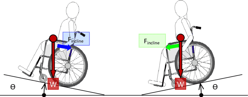

How do I calculate the required push force (in kgf) for pushing a wheelchair up a ramp?
- the ramp has a 5 degree incline
- the weight of the chair and person in it totals 96.8 kg
- the wheelchair has 4 wheels, all of equal diameter (15 cm)
- the wheels on the wheelchair have a rolling coefficient of friction with the floor of 0.1
I am really stuck on this. Any help would be greatly appreciated thank you

I don't think either of those is relevant. Friction between the wheels and the ramp doesn't contribute to a retarding force (unless the wheelchair's brakes are on, which would make no sense). The component of the weight of the wheelchair in the direction parallel to the ramp is one force, and the "rolling resistance" of the wheels is the other force that you need to overcome. The rolling resistance consists of the bearing friction for the wheels and any deformation of the wheels at the contact patches. Are the wheels pneumatic or solid rubber?

Perhaps one reason you are stuck is that the problem conflates 'force' and 'velocity'. That is, since a resultant *acceleration* of the wheelchair is not provided, you are most likely assuming the wheelchair moves at a constant velocity. So, if the wheelchair moves at constant velocity, you can use a reduced form of Newton's second law (or two N2s in combination: one for linear motion and the other for rotational motion, connected by the assumption of rolling motion) to figure out what the applied force must be.
Well, let's give the OP an initial ballpark estimate of the force. Hopefully that helps some.
All of the wheelchairs I've pushed in healthcare settings have solid rubber wheels, and very little rolling resistance. A 5 degree incline is pretty gentle, but let's assume that the rolling resistance is a negligible retarding force. Let's also assume that a helper is pushing the wheelchair at a constant velocity. Then the force required is just the component of the weight in the direction parallel to the incline:
[tex]F = m * g * sin(5 degrees) = 96.8kg * 9.8 \frac{m}{s^2} * sin(5 degrees) = 82.7N[/tex]
82N is about 20 pounds of force. Does that help?
https://www.researchgate.net/profile/Catherine_Holloway/publication/267995686/figure/fig4/AS:669371231920138@1536601946564/5-Forces-acting-on-a-wheelchair-going-up-left-and-down-a-slope-W-is-the-weight-of.png
