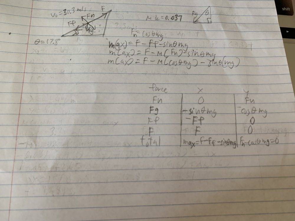

I made a component diagram of the forces acting on the skier. I got a horizontal force equation as m(ax) = F - u(cos17.8)mg-sin(17.8)mg, but am confused on how to proceed forward.

Hi, to start I suggest to use the energy considering also the work done by the friction ...
Ssnow
I included frictions as Ff=u(Fn)

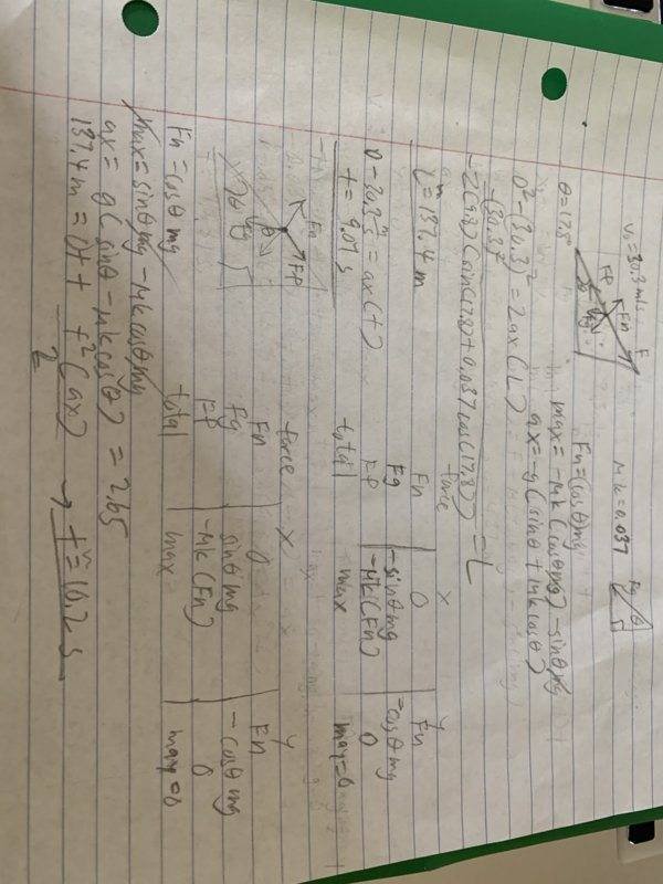

I've apparently misused the initial velocity : I was supposed to use 30.3m/s instead cos(17.8)*30.3. I rework the force component, and this is my answer.
(Sure you must use the decomposition on the incline plane ...). You can start to fix the variable ##h## that is final height (what you must find...). Now at the beginning you have a kinetic energy ##K## that is transformed in potential energy ##U##. The work ##W## done by the friction is equal to the difference ##K-U##. So you have the equation ##K-U=W##...

Remember that the space covered by the skier along the inclinate ##x## plane is related to the maximal height ##h## by the relation ##h=x\cdot \sin{\theta}##...

Though the images don't look good (not good handwriting either) and I had to use software to rotate and magnify them (ok that was not hard but still) I recommend you learn to write equations with ##\text LATEX## commands. It will require for you some extra time to learn it and type your work every time you have a problem , but I am sure it will be beneficial at the end.
I found your work and equations correct though I didn't check the arithmetic.
Also i believe it would be beneficial to do it using the energy approach like @Ssnow suggests so you can cross check the results.
