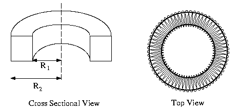

"The toroid shown in the figure has a wire carrying a current I= 7.80 Amperes wrapped around it N= 920 times. The inner radius is R1 14.0 cm and outer radius R2 16.8cm. What is the magnitude of the magnetic field along a circle that is halfway between the inner and outer edges of the toroid?"
Magnetic field of a Toroid: B=μ0NI/2πr
B=magnetic field
μ0=permeability constant=4πx10-7 N/A2
N=number of times the wire is wrapped around the toroid
I=current
r=radius
Since the problem is asking for the field in the middle of the toroid, I decided to set my radius to halfway between the outside and inside:
16.8 cm-14 cm=2.8 cm
r=14+2.8 cm=.168 m
When I plug in this and all the variables given to me, my answer comes up wrong. Is there a concept I'm missing? My class never covered toroids so I'm pretty much on my own for this one.

Hey man, instead of in the middle you just wound up back at the outer radius for your value of r!
Compute r again.
