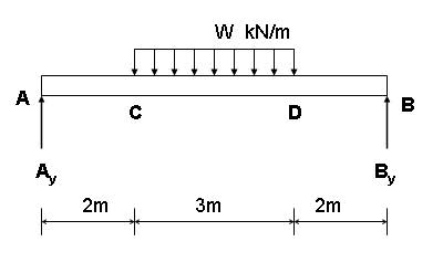

A simply supported beam is loaded with a uniformly distributed load (UDL) W=40 kN/m from C to D. The maximum Bending Moment value occurs at the mid-length of the beam, i.e. 3.5 m from the left hand end A. What is the value of the maximum bending moment? Give your answer in kNm, with 1 decimal place.

Yep. Thanks. I have tried to calculate the it using +(p*d)-(ws)(GX). For this question, i used, (120*3.5)-(40*3)(1.5). Did i did anything wrong?
Did you construct a shear diagram for your problem first?
Turn the UDL into a point-load.
