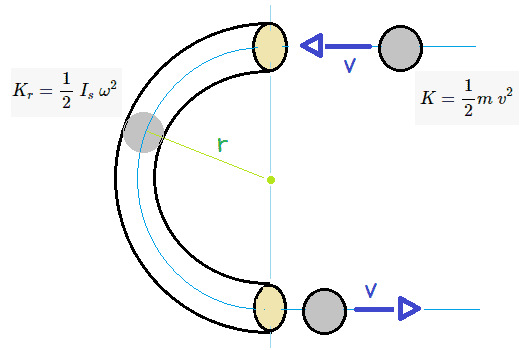

Now, what I think about your problem.
Before and after the turn, you have a Kinetic Energy for the moving object, with mass m and a linear speed v ...
[tex]K = \frac{1}{2}m \ v^2[/tex]
In the turn, you have a Rotational Energy ...
[tex]K_r = \frac{1}{2}\ I_s \ ω^2[/tex]
So which is the problem in my opinion? If both energies don't match, then you'll have an inelastic "impact" both when entering the turn, and after when leaving the turn. Greater the mismatch, greater the "hit" to the moving piece.
Doing very, very rough numbers, the tension wheel should rotate, for example, at 30 rad/s (now is at about 45 rad/s). If you need to mantain the same linear speed, the radius of the tension wheel should be 1.5 times greater.
Take it with a grain (or two) of salt.
The energy is not in itself a problem. Forces are the problem.
Match? As in, same magnitude? What has that to do with anything?!

Ok, let's say that the object enters the turn with a kinetic energy of 1 unit ... this object is not in free movement, because is being pulled by the chain, but when it enters the turn, its energy (kinetic) is 1 unit.
While in the turn, its energy, due to its moment of inertia and angular speed forced by the chain, has to be 3 units.
Can you tell me where it gets this "extra 2-energy units"? You tell it, of course because there're acting forces. The forces act suddenly, because in a very short time, the energy of the object has to increase from 1 unit to 3 units.
At the exit of the turn, the energy of the object has to decrease suddenly from 3 units to 1 unit.
(The 3:1 ratio is a rough estimate I've made, based on the drawings of the machine and its elements).
Did you understand it?

In post #17 I included this drawing...
You put words in my mouth that I did not say! According to may view, the centripetal forces (done by the walls) do turn the ball. What you don't seem to realize is that the kinetic energy at the entry of the turn, is the rotational energy during the turn (if the body moves freely).
If you substitute the value of ω by v/r, and assume that the ball is a "point mass", you'll see that's the same thing.
And for me, given that you have to make a turn and you go to a certain fixed speed, then the best choice is to balance the kinetic entering energy with the rotational energy ... or this is not true?

I assume in this diagram that the ball is frictionless, so is not rotating on its own centre. Or that might as well be the case. That means there is not essentially any rotational KE involved. Yes, you can choose to view it as rotational KE by choosing a an axis off to the side, as you have done, but you can do exactly the same with constant velocity motion.
Try this: a rod is moving laterally at a constant speed. One end encounters a rubber stop and bounces elastically. This converts much of the linear KE to rotational, but there is no net change in KE.
By your reasoning, there is no stress on the rod, right?
