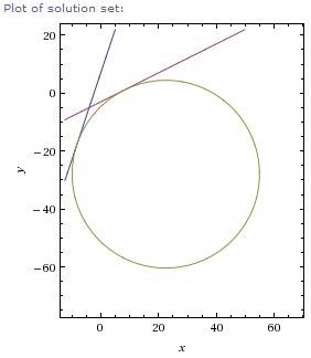

We can find two circles satisfying the given requirements. You would have found the other radius by considering the other bisector. I will use an algebraic approach instead.
Given that the point (8,1) is on the circle, we know:
\(\displaystyle (8-h)^2+(1-k)^2=r^2\)
Since the circle is tangent to the line \(\displaystyle y=3x+7\), we may write:
\(\displaystyle (x-h)^2+(3x+7-k)^2=r^2\)
\(\displaystyle (x-h)^2+(3x+7-k)^2=(8-h)^2+(1-k)^2\)
Expand and write in standard quadratic form
\(\displaystyle 10x^2+(42-2h-6k)x+(16h-12k-16)=0\)
and require the discriminant to be zero:
\(\displaystyle (42-2h-6k)^2-4(10)(16h-12k-16)=0\)
\(\displaystyle (21-h-3k)^2-40(4h-3k-4)=0\)
\(\displaystyle h^2+6hk-202h+9k^2-6k+601=0\)
Doing the same with the other line, we eventually find:
\(\displaystyle k=17-2h\)
Now, substituting this into the first equation, we find:
\(\displaystyle h^2-28h+124=0\)
\(\displaystyle h=14\pm6\sqrt{2}\)
Case 1: \(\displaystyle h=14+6\sqrt{2}\)
\(\displaystyle k=-\left(11+12\sqrt{2} \right)\)
\(\displaystyle r=6\left(\sqrt{5}+\sqrt{10} \right)\approx32.390073826009015\)
Plot of lines and resulting circle:

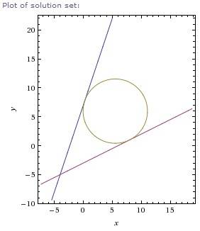

Case 2: \(\displaystyle h=14-6\sqrt{2}\)
\(\displaystyle k=12\sqrt{2}-11\)
\(\displaystyle r=6\left(\sqrt{10}-\sqrt{5} \right)\approx5.55725809601154\)
