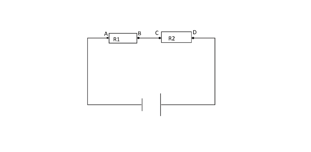

I think the current is the electrons that move because of potential difference. When electrons passing through a resistor they lose some of their kinetic energy. I guess that we can calculate common resistance by the sum of the resistance R1 and R2 because total less of energy wil be equal to loss of energy if current goes through the resistor of resistance R1+R2. But I can't understand why the electrons don't get energy going through BC?

Your explanation is almost correct. You can imagine the electrons as moving at constant speed. They do not lose kinetic energy. They lose potential energy when the go through a resistor. The potential energy lost is converted into heat. The rate at which energy is lost in the resistor (power) is given by ##P=I^2R##. Segment BC in your drawing has zero resistance, therefore no power is lost there.

Because there are no power sources between B and C.
Imagine a ball is pushed into a tube at the negative side of the battery, such that the ball attains a certain velocity. Then, at A, the ball is slowed by R1. Once at B, it reaches a new (slower) velocity and continues to roll at that velocity until it reaches C. Then it is slowed down again through R2, having a new velocity ##v_f## at D. And the ball will keep rolling down the tube at ##v_f## until it reaches the positive side of the battery.
Between B and C, there are no gains or losses in energy. Just like between the battery and A or between D and the battery.
