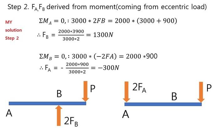

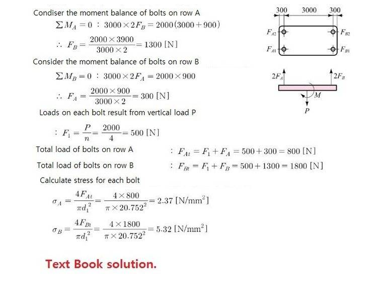

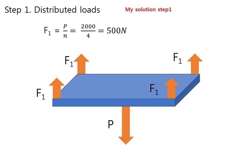

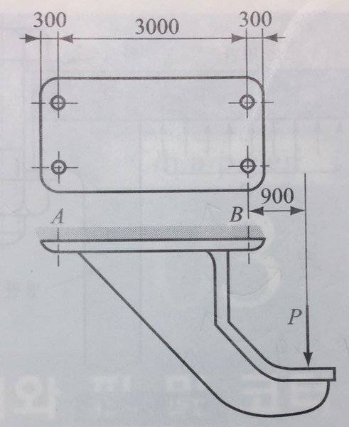

A hanger is fixed from the ceiling by using 4 bolts. The diameter of bolts are d=20.752mm, and load is equal to P=2kN. Determine normal stress of 4 bolts
why the Pa= +300N(upwards) is?

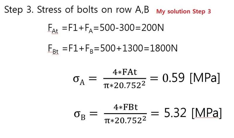

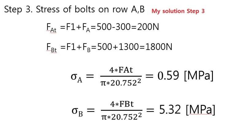

i think it should be -300N(downwards) like my solution(below).
and
Fa = 500 - 300 = 200N
but the solution and other problems solve like that(Fa=500+300)
stress = load/area
moment = load*length

Are you aware that this is a statically indeterminate problem? You have attempted to reduce the indeterminacy by assuming symmetry, but that may not be valid. There are basically 4 unknown bolt loads and only 3 equations available (two moment sums and one force sum).
With the assumptions you have previously made, the results are
Fa1 = Fa2 = 300 N down
Fb1 = Fb2 = 1300 N up

Looks to me like both you and the text are wrong. The text messed up on the negative sign...you were OK here. But beyond that, you and the text both added the vertical load distribution of 500 to each bolt, but this is not correct. When you consider sum of forces in y direction must be 0, you get that sum as 2000, not 0.
So what's your solution about this problem?? I think it is okay...
Hi
The textbook solution is incorrect. Your solution is incorrect. Dr. D has given you the correct answer for bolt load. You should explain why, and also explain the significance of the plus and minus sign (up and down loads).
