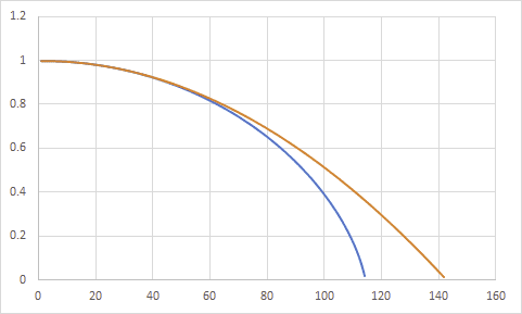

Here is the numerical solution:
Orange assumes constant acceleration, blue assumes it goes as 1/r2.
As you see, the collision happens ~20% sooner if the change in acceleration is considered.
I don't know if it is analytically solvable. If it is, the solution probably involves the equal areas in equal times rule, applied to a circular orbit and again to one where the semiminor axis goes to zero.

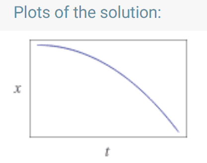

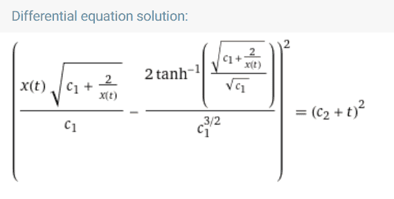

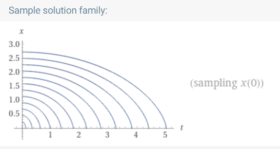

69911e said:
Just for my knowledge, can the Acc =1/x^2 be entered into Wolframalpha or similar program to get a graph of distance/time? If so, what would I type in?
Yes, you type in
x''= -1/x^2, x(0)=1,x'(0)=0​
You can also leave out e.g. the x(0)=0
Wolfie then 'samples' x(0) and scales the axes
If you leave out both, a 'solution' is shown
But I don't get it... (more o:) :cry: )
