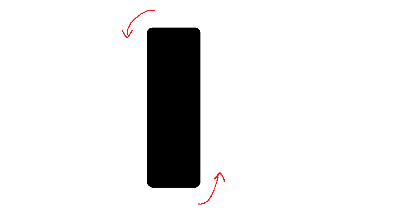

Assuming the cylinder is rotating on one axis the long ways (flipping over itself). I calculated the time required to stop the rotation based on a given force value.
Rotation Like: https://pasteboard.co/fjvq76T45.png

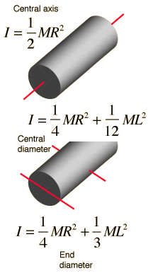

I would want to use inertia, I = (m*r^2)/4 + (m*L^2)/12? Is that correct?
That will only apply if the mass of the barrel and it contents are equally distributed throughout the length of the barrel (ie, a totally full barrel of a homogeneous contents); otherwise, as if a mass or weight is located at or toward the ends of the barrel then that must be treated as an I x r object relative to the axis of rotation.

Torque = MassMomentOfInertia X AngularAcceleration
For your case of cylinder rotating about transverse axis, Wikipedia (and many other sources) show the MomentOfInertia as this (I-sub-x or I-sub-y)
AngularAcceleration =~ DeltaAcceleration / DeltaTime = [ CurrentRotationalVelocity - FinalRotationalVelocity ] / [ TimeRequired ]
CurrentRotationalVelocity = whatever is rotation speed
FinalRotationalVelocity = 0 (zero)
In what time duration do you want to reduce the rotational velocity to zero? That = TimeRequired
Plug & Chug to get Torque required to spin that cylinder down to zero in TimeRequired.
