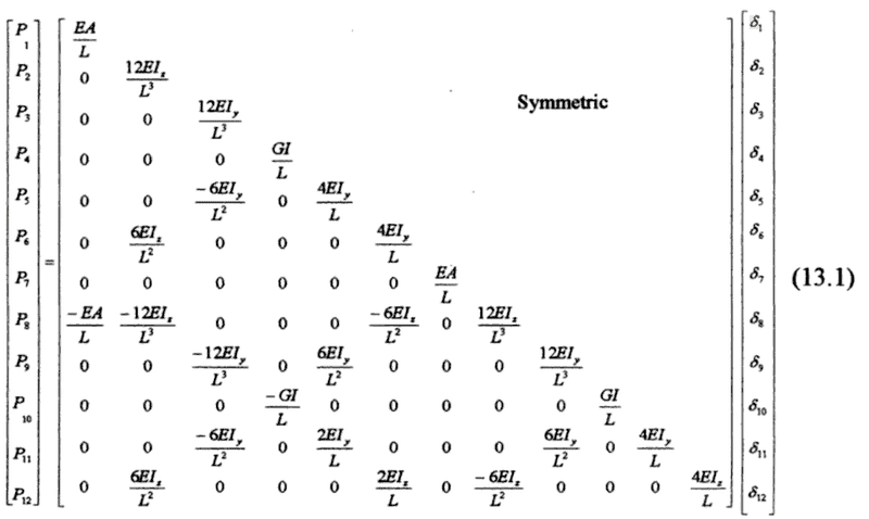

I´ve tried to calculate the vibration modes of beam in the space, without gravity or any other force.
The forumle of the beam is this one: Cos(λL)*Cosh(λL)=1 from which I´ve calculate the roots and the resonance.
I´ve found a programme for Matlab that calculates the vibrations modes if you enter the mass and stiffness matrix but it´s here where I´m facing some troubles. I don´t know how to build the stiffnes matrix of this beam.

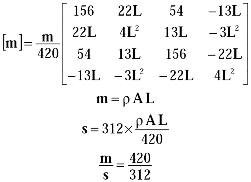

For the mass matrix I´m going to use this methog. Do you know if it´s going to work properly?
I´ve all the dimensions, density and the young´s modulus of the material (steel).
Thanks in advance.

The following is a typical stiffness matrix for a beam with 6 DOF at each end node:

I think that ´s exactly what I´m looking for.

Do you know if the mass matrix I posted will work?

One of the difficulties that you will encounter trying to do an eigenanalysis for a free-free beam in space is that the stiffness matrix is singular. There will be several zero eigenfrequencies (how many depending on the way you model the beam). This is not a simple problem.
