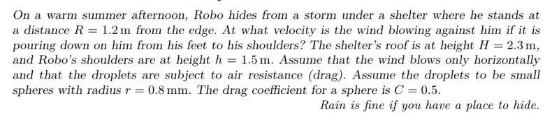

I think I cannot solve it, so what is the solution? Because in this problem below,
I used exactly that my equation above and I got a correct solution. So doesn't the solution correspond to that equation?

For the problem above you don't need time. Just assume terminal velocity, where drag balances gravity, and horizontal velocity equals wind-speed. In the rest frame of the airmass the drop just falls vertically, so the drag is only vertical.

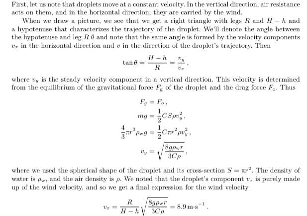

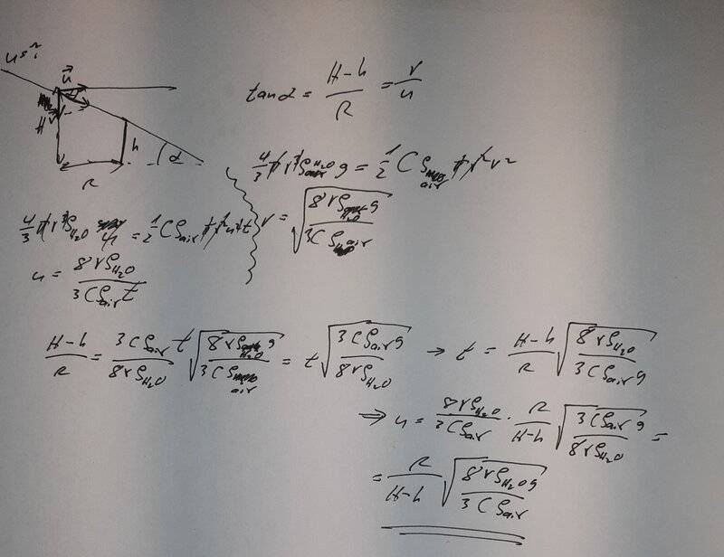

My solution:
The "official" solution:
I have the same result, so how is that possible when my main equation is wrong?

It is hard to say because your handwriting is difficult to read, however it seems likely that you have made a compensating error. Given that the correct equation is ## \frac 12 C \rho Su^2 = mg ## whereas you have ## \frac 12 C \rho Su^2 = m \frac ut ## I suspect that you have somehow managed to use a numerical value for ## t ## that makes ## \frac ut = g ##.

What this solution indicates and the problem statement fails to mention is that the droplets are traveling with the air velocity in the horizontal direction, such that $$u=u_{air,x}-u_{drop,x}=0$$Also, the velocity of the air in the vertical direction is zero, such that $$v=0-v_{drop,y}=-v_{drop,y}$$, and $$V=\sqrt{u^2+v^2}=v_{drop,y}^2$$So $$F_x=0$$$$u_{drop,x}=u_{air,x}$$and $$F_y=\frac{1}{2}C\rho Sv_{drop,y}^2=mg$$

What this solution indicates and the problem statement fails to mention is that the droplets are traveling with the air velocity in the horizontal direction.
To be fair the OP did mention this:

OK, I understand that this equation for the horizontal velocity ##\frac 12 C \rho S u^2t=mu## is wrong because the velocity in the drag formula is relative and when the drop has a wind's velocity the force is zero, but how to calculate the wind's velocity using the drag force formula for the horizontal direction?
I understand the "official' solution but I wanted to solve it differently. But the steps should be similar, shouldn't they? I need to express the velocity ##u## using time ##t## as I did it in my solution, then calculate the time and by using it express the unknown velocity.
However, I still don't understand how it is possible that I got a correct solution when my equation for the horizont velocity was wrong. Is it only a coincidence? But it is a weird coincidence.

Not a coincidence, a compensating error. The key to the solution is understanding that the ratio of the horizontal and vertical components of velocity is determined by the fact that the raindrops hit Robo's shoulder, and that the vertical component of velocity is simply terminal velocity. The equation you wrote down incorrectly for horizontal drag force (which is of course 0) was nearly the right one for (vertical) terminal velocity, and the way you used it to calculate time compensated for this.

Again you have got the right numerical answer because you have calculated ## u = \frac xt ## and ## v = \frac yt ## so your meaningless value of ## t ## has cancelled out of the answer given by ## \frac u v ##
