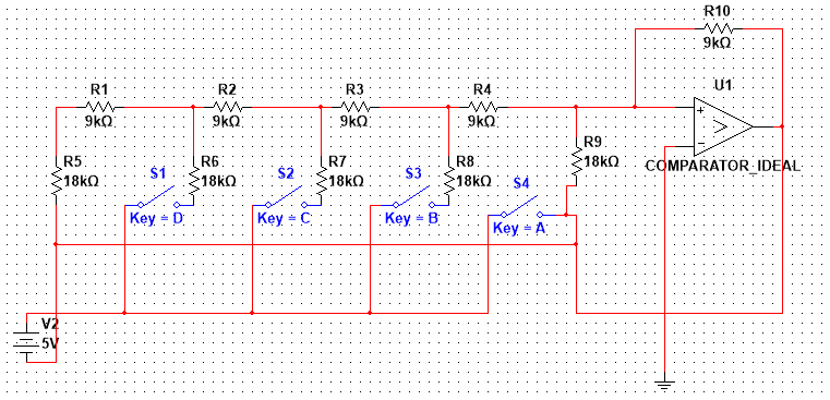

please can somebody help me, how to calculate this 4 bit dac,
i know this one if input 1.1.1.1 5/2, 5/4 5/8 5/16 voltage
i don't understand nothing i search on the internet but i don't find some useful example,
my english is not so good...
please one more time can somebody explain me how to calculate, for formula thanks
Try again, using the search terms R-2R ladder DAC.
After you have done that reading, try again to work your schoolwork problem and post your work here so we can check it.
BTW, can you check your circuit, as I think the op-amp has the inputs reversed.
Good catch!

Also, you show the output component as a Comparator. It should be a Op-Amp, not a Comparator.
You really should look up another version of the R 2R ladder.
-1 if key A is closed, the positive supply is short circuited to the output of the op-amp. That won't end well.
2 R1 shouldn't be there.
3 The ampiflier you connect the R-2R ladder to should have infinite (much larger than R) imput resistance.
4 The inputs should be connected to either 0 or 5 volts, and not left unconnected.
The last point is essential to make make the superposition principle work. If you have a network of resistors and voltage sources, you can calculate the effect of a single voltage source by replacing all the other voltage sources with a wire. You can than sum those indivudual effects to get the output voltage. Replacing the voltage sources by open circuits won't work.

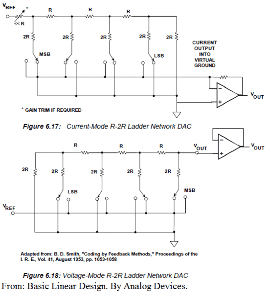

Good Morning
i solve all the problme with voltage divider i find all the values.
but the problem is, when i push key D, the voltage of D is the same(like i find it with voltage divider), but the voltage on c,b,a they have other value?
how do i calculate ?because i draw the circuit in gsm (every circuit)
thanks...
The circuit in post #1 is a weird mix of several ideas.
Please post your revised circuit diagram.
