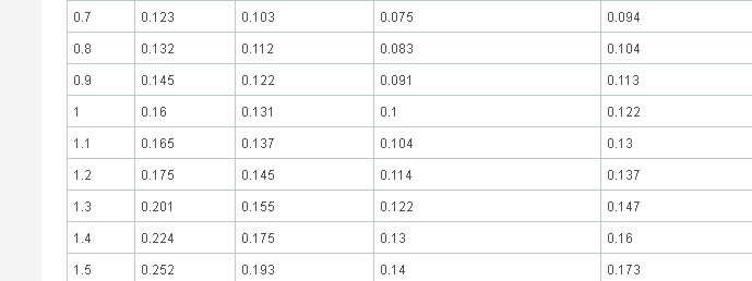

Hello hardy sir
  • Thanks for your replay and all your suggestion. This page have one table under power handling capacity in that table current density A/mm2 depend on toroidal core wet. my core wet is 1842 grams according to that table if core wet is under 3500 grams current density should be 3.1A/mm2.

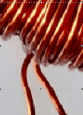

Finally Done primary winding today of my toroidal core.Attach photo of transformer below.
755 turn of 0.914 mm magnet wire.
core size before winding OD-100mm, ID-60mm, Ht-50mm (M4,CRGO) as we discuss early.
Sir when I test for secondary voltage I get 2.7 volt on 10 turn of magnet wire . why I get less volt per turn. Because before full primary winding when I wind 10 turn for testing perpose on core I get 3.2 volt.Please replay soon
230 volts across 755 turn primary = 0.305 volts per turn
That's how much flux is in your core and that's what it will induce into secondary.
Do you have a slider transformer(Variac) ?
The .27 volts per turn you measured sounds about right
try swapping your volt meter leads, the one turn they complete might explain the 10% difference between .27 and .305
old jim
Ahh i missed that part , you tested it with a partial primary ...
How many turns were on your primary when you made that partial test ? Sounds like you had a lot fewer.
Volts per turn is the key to understanding what goes on in a core, it's a measure of induction (amount of flux)
The fewer primary turns, the more volts per turn
so when you tested with a partial primary, what was the turns ratio?
Very nice looking job in the pictures, by the way... Will you tape it when through? Or dip in varnish ?

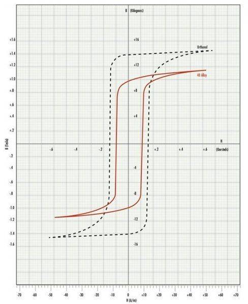

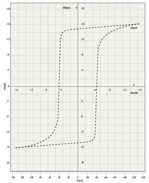

http://www.mag-inc.com/products/tape-wound-cores/typical-hysteresis-loops-for-tape-wound-cores
old jim
  • #35
jim hardy said:
sorry, i missed your earlier reply
from your first post
let's see
that gives for cross section 2cm difference in radius X 5 cm height = 10 square cm = 0.001 square meters
looks right to me !You must have a pretty good core there.
View attachment 104285old jim
Hello hardy sir
So my core is not saturate in 400 va use what's your thought .I think theas charts not for toroidal core (m4 crgo)
  • Electrical Engineering
