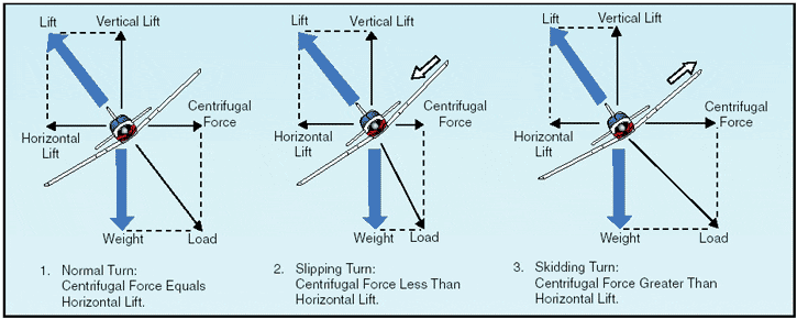

sorry about that, I'll attempt to be less vague, by tilt of the wing what I probably should have said was that the Roll of the plane being 28 deg off level. ( with all other factors being 0 )

Sorry, that was an oops on my part, meant to indicate a Roll angle of 28 deg.
there are diagrams in books that have arrows showing the lift vector, & drag & gravity,
Just trying to get a handle on the magnitude of the vector(s) in this case. ( clear 'nuff, or? )

... meant to indicate a Roll angle of 28 deg.
Something like this?
Likes Astronuc and russ_watters
If you just want to represent the lift components when there is a roll angle of ##\phi_{deg}## degrees, the equations are:
##\phi_{rad} = \phi_{deg} * \pi / 180##
##F_{vertical} = F_{lift} * \cos(\phi_{rad} )##
and
##F_{horizontal} = F_{lift} * \sin( \phi_{rad} )##
Where ##\cos## and ##\sin## require inputs ion radians (that is usually true).
