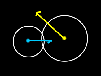

Basically I have a point cloud that represents balls with different radii. They are all moving based on forces and sometimes they are intersecting with each other.
Imagine the yellow ball is going in one direction while the blue balls goes in another direction. At one time they are colliding. How can I affect each sphere,s velocity or force so I can update it after the collision?

Thanks alot. Since these are all particles, I don't have the point of contact, just that some point with a radius A is within my radius of B and so I should react. I need to find a way to find this point of contact given the 2 centers of the spheres and radii. Can that be done mathematically?

I am just tracking the centers and know their radii. I made more progress though. I just need to perform moving sphere sphere collision like this:
"Moving Sphere/Sphere: (location) Add the radius of the moving sphere to the static sphere, and treat the moving sphere as a ray. Use this ray to perform ray/sphere intersection. See Gomez; Schroeder for code (article has bug in derivation, code is fine); and RTR2, p. 622."
If I do this, I should have hitpoint, normal, distance, etc so after that only thing I would need is to figure out how to calculate a force from that so I can apply it to the current point/sphere.

The force is going to depend on the object you want them to model. Maybe you should treat them as having a membrane? Then model the interaction as a spring, with x being the radius and x hat (direction) being in the radial direction (which we talked about earlier). Or are you looking for more of a pool ball interaction? Try giving this a look. They seem to do a decent job explaining it: http://www.real-world-physics-problems.com/physics-of-billiards.html

So they solve for your change in velocity, which is ultimately what you're looking for, right? The only thing, is that you'll have to break this down into chunks, or pixelate it, or step it or however you want to call it. So the premise is this: billiards are springs. The spring constant is fixed, and the mass of the oscillator (the mass of the billiard ball) is fixed, therefore the time it takes for the collision to occur is fixed. If you've studied lagrangian mechanics/oscillators (these 2 seem to go hand in hand), you'll have seen ##\omega = \sqrt{\frac{k}{m}}## with omega being angular velocity, or rate of compression of the spring (billiard ball), k being the spring constant, and m being the mass.
So go through the article, or at least the first little bit, as that's what I thought was necessary, decide on the mass of the objects, the spring constant, and that will give you the time you need. Then, along with the angle of the collision (arctangent function in code), you can get the direction of the force. Now you have the magnitude of the the force, the time interval for the force, and the direction for the force: everything you need for a vector impulse, which is the change in momentum, and change in momentum/mass is change in velocity.
