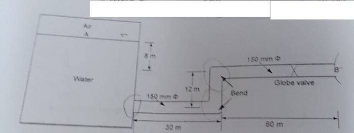

water flows from flow tank at A through cat iron pipeline to free surface at B . Given friction factor , f = 0.023, kinematic viscosity = 1.02 x10^-6 (m^2 0 /s , coefficient of losses for entrance , bend , valve = 0.5 , 0.9 and 10 . [/B]
in this question , i am asked to find the velocity , flow rate , type of flow and pressure at A .
for the first part , I'm asked to find the velocity . The flow rate is not given , how could the velocity be found ? Since Q = Av ,
