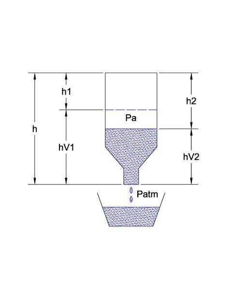

Is this diagram correct?
Likes evelynhott
evelynhott said:
Yes, it's perfect
Then, let's go to post #11 above.
While the mass of liquid is moving downwards, Newton's laws are in display, because the vertical forces acting in that mass are not balanced.
Therefore, after the natural leak stops, there is balance of vertical forces.
Static pressures directly above and below the orifice are equal.
Could you explain the reason for that to be?

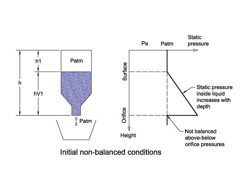

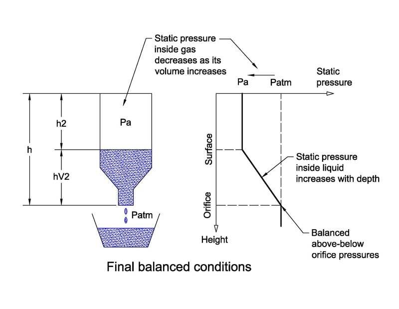

Please, see how the initial atmospheric pressure above the liquid becomes Pa:
Likes evelynhott

  • #34
Lnewqban said:
Pretty close; you are almost ready to redo the calculations of that pesky Pa.
Very nice illustrations, thank you!
Now I'm a little confused. Patm=Pa+ρhv,1g?
Likes Lnewqban
