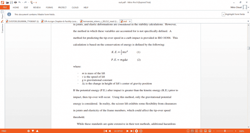

Hi, here i need to calculate the tilt angle of the scissor lift. I had done some reviews for designing a scissor lifter, some source state that, tip-over will happen only when the kinetic energy of the system is less than the Potential energy after impact.
Hence, i was trying to use this relation to find out the range of the best angle. But, i don't know how to calculate the Kinetic Energy of the whole system. Can anyone give me some idea to solve it?Thankyou in advance!

Which source? That sounds strange.
Do you have a sketch, including where you expect an impact?

Here was the paper i got. In the Chapter 2,the author did mention about the potential energy after impact greater than Kinetic energy will lead the tip-over to happen.

I did try to look at all my mechanical textbook for dynamic or static analysis. And what i found is, scissor lifter having only one degree of freedom, mean this structure having only vertical motion. Therefore, i try to calculate the velocity of the lifter by differentiate the vertical displacement of the center of mass of the whole structure. After comparing both potential and kinetic energy, there was a huge differ. The kinetic energy has a much lower value than the potential energy value. It seem something is wrong.
Wondering about the statement from the research paper.

Can you post a link to the whole paper?
... i try to calculate the velocity of the lifter by differentiate the vertical displacement..
When they say "KE prior to impact" I took that to mean 0.5mv^2 where v is the horizontal velocity. Not sure why you are looking at the vertical velocity.[/quote][/quote]
